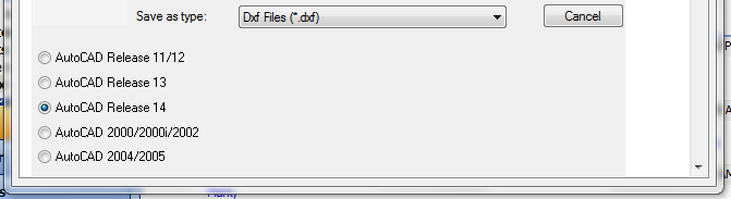

ReMark Posted June 5, 2013 Posted June 5, 2013 Here are the export options for Procut to AutoCAD. Quote

ReMark Posted June 5, 2013 Posted June 5, 2013 Changing the file type designation won't work. The customer can actually export to both the DXF and DWG file types from Procut as depicted in post #29 and confirmed by the sales rep previously. Quote
