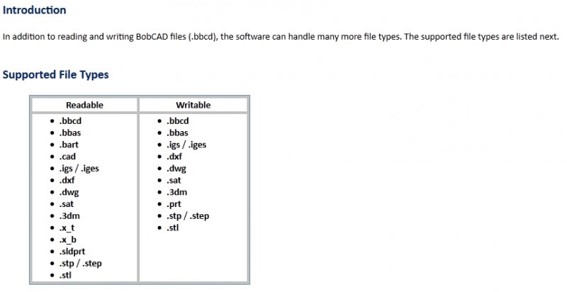

Nayfb Posted June 4, 2013 Posted June 4, 2013 Hello all, Nathan here. I found a little thread on this before but nobody actually came up with an answer to the question. A customer has sent me a .CAD file, which i cannot open with the programs i own, does anyone else know what program can open this file type? Any positive response is much appreciated people. Many Thanks in advance, Nathan Quote
dbroada Posted June 4, 2013 Posted June 4, 2013 I'm guessing you have found this thread already. http://www.cadtutor.net/forum/showthread.php?58770-How-do-I-open-a-.cad-file-type I think your best bet is to follow the advice there of asking your customer if he can save the file as dwg (or maybe dxf) so that you can open it. That thread also suggests that you nay be able to download QuickCAD to do the conversion yourself. Quote
Nayfb Posted June 4, 2013 Author Posted June 4, 2013 Hey, Firstly thanks for your prompt reply, Yes i found that before but couldn't find any answers to my problem, which is why i thought id try a fresh approach. I already have, but the program they use is on a subscription basis and only outputs with .cad, .dwg output doesn't work for them. and obviously i don't want to have to pay to a subscription for the software for only one customer so i was just wondering if there was another program that could run this file extension. Thanks again. Quote

ReMark Posted June 4, 2013 Posted June 4, 2013 What is the name of the program your customer is using? What, if any, file types can they EXPORT to? This is not the same as SAVE as. Quote
f700es Posted June 4, 2013 Posted June 4, 2013 Could be QuickCAD, AutoSketch or even Drafix. All of these can export to .dwg or .dxf Quote
Nayfb Posted June 4, 2013 Author Posted June 4, 2013 They can only export and/or save as .CAD files. They say they use a program called ProCut. Quote

ReMark Posted June 4, 2013 Posted June 4, 2013 Sometimes you just need to go right to the source which in this case would be the makers of Procut. I asked what file types could be used when importing or exporting. Here is the response I received. * * * * * * * * * Good Morning Mark, Procut can import DXF, DWG, StruCAD (Cam & Fit files) and Tekla or Advanced Steel (NC1 files). Procut can export to DXF & DWG. I hope this helps, if you need anything else re: Procut please ask. Regards Dave Ward Procut Software Sales, Support & Training Phone 0115 9210411 Office 0115 9391888 * * * * * * * * * * Exporting to DXF and DWG is possible but I wonder if this capability is version specific? Ask your customer what version they are using. Quote
