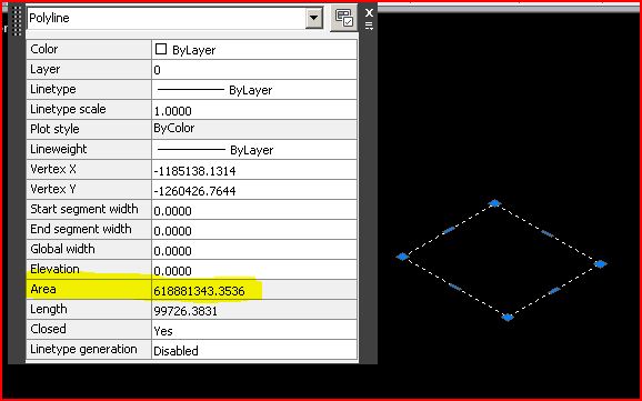

Welcome to CADTutor. :)
You could get that information on the fly from QUICK PROPERTIES, regardless of your perspective.

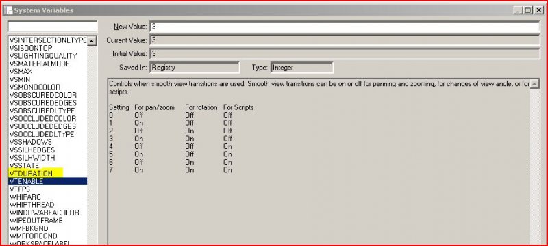

Looking through the SYSVDLG trying to figure it out, and I am putting this suggestion up from way downtown.
You might check the variable detailed in the attachment, and you might want to try changing VTDURATION to 0.
