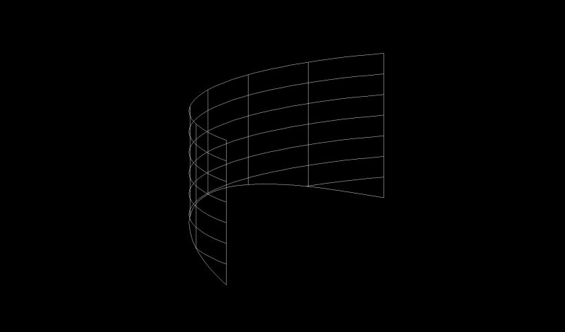

guran Posted May 31, 2013 Author Posted May 31, 2013 What I'm after is just not that complicated, it can be as simple as in this image. I would like to be able click on it and get it flattened. Quote
ReMark Posted May 31, 2013 Posted May 31, 2013 You can flatten it in AutoCAD alright (via the FLATTEN command) but you won't get the result you are looking for. Quote
JD Mather Posted May 31, 2013 Posted May 31, 2013 guran said: What I'm after is just not that complicated, it can be as simple as in this image. I would like to be able click on it and get it flattened. Are you a student? If so, you can download Autodesk Inventor for free from http://www.autodesk.com/edcommunity or download 30-day trial or attach your dwg file here and indicate the thickness (inside, outside or midplane) and material. Quote
tonyj Posted June 1, 2013 Posted June 1, 2013 (edited) guran said: What I'm after is just not that complicated, it can be as simple as in this image. I would like to be able click on it and get it flattened.[ATTACH=CONFIG]42173[/ATTACH] What is the thickness of the material? What type of material is it? What is the radius of the arcs? Where are the arcs in relation to the material? ie. are the arcs that you have drawn, to the inside of the finished plate, or the outside, or are they at some point in between? When you answer those questions your problem can be solved in autocad.? Ps. You can never get autocad to 'click on it' and give you the result you want. How-ever with a few elementary lessons in metal rolling and folding you can create accurate flatstates in autocad. This normally takes about 6 times longer than it takes in pro-e or inventer. Average sheet metal parts for conveyors, hoppers, chutes and guards in autocad after been modelled, in solids, can take 2 to 8 minutes to flatten out per part, with fold lines, in autocad. Not only that, but you can create flat states in autocad more accurate than pro-e or inventer can and I can explain why that is. Edited June 1, 2013 by tonyj Quote
JD Mather Posted June 1, 2013 Posted June 1, 2013 tonyj said: .... but you can create flat states in autocad more accurate than pro-e or inventer can and I can explain why that is. Start explaining. Quote

tonyj Posted June 2, 2013 Posted June 2, 2013 JD Mather said: Start explaining. Right. I work in autocad and when i'm creating mild steel sheet metal parts I use a k-factor of .44 We have three engineers in our company using pro-e. Now pro-e has got a y-factor (which is unique to pro-e) and the y-factor is : Y-factor=k-factor(pi/2) and by default the y-factor in pro-e is set to .5 and therefore leaves the k-factor set at about .3 Now anybody using pro-e that is not aware of this and working in mild steel is using the wrong k-factor. BTW the k-factor for mild steel should be .44 and I have tested this on our press and found it to be suitable to the machine. Most people using pro-e or inventor are grads, and you can tell them nothing. Quote

tonyj Posted June 2, 2013 Posted June 2, 2013 Just to be clear. You can adjust the k-factor in pro-e and the y-factor gets adjusted in relation to that. The main point is that, unless a person using pro-e has a decent understanding of sheet metal bending they will be using the wrong k-factor. So I would say that there is a high percentage of pro-e users out there doing drawings of metal parts that are not correct, and I can produce these more accurately in AutoCAD than them in pro-e. Stykface, I am doing this on a manual basis. I have done metal parts in pro-e (with the k-factor set correctly) made the flatstate and then imported the model into AutoCAD and made a separate flatstate in AutoCAD. The results are identical. Quote
