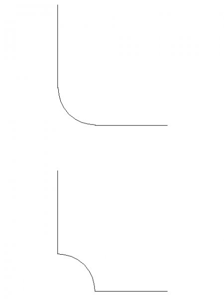

How can I Create inverted fillet
drawing describes the required
Circle with the TTR option then trim away the unnecessary parts.
Or fillet the lines with the required radius and mirror the quarter circle on its end points.
Thanks to everyone
But this picture is an example, there are more complex forms such as arc R 95
When i draw it It come inside, and hard to find a center
That arc is created with the method I described. It is commonly used by many a CAD tech.
Thank you for fast response :)
I wanted a way using Fillet
but it looks like I will use the TTR way
I'll put it to you bluntly. FILLET will not work without creating extra work for yourself. Use the method that does and you'll make your life a lot easier.
