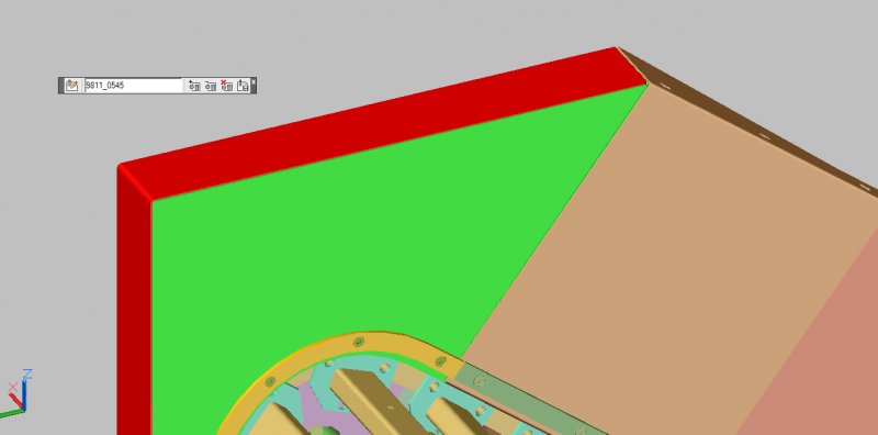

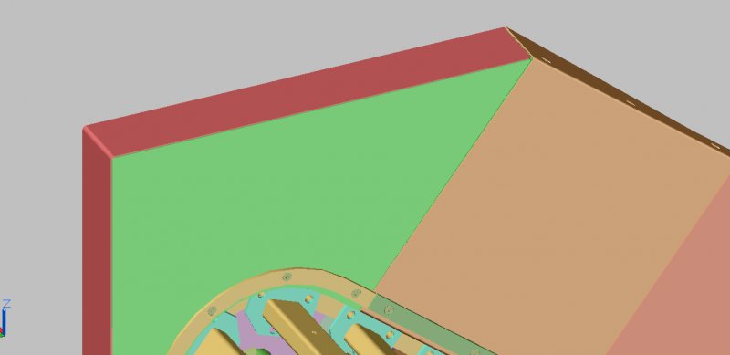

tonyj Posted May 22, 2013 Posted May 22, 2013 I have a problem with the visual style in a drawing. It is only happening in one particular drawing and came on suddenly. It is a 3d model of solids that are all made into blocks etc. When I am viewing the drawing in 'shaded' mode, all the solids look as if I am modifying a block, and the whole drawing looks like the ones that are not been modified. I hope that makes sense. I have opened another drawing that does not have this problem and compared the styles and they are identical. In options, on the display tab, fade control is set to 70 and this is what I always have it set to. If I do modify a block in the drawing everything is normal, the block been modified is brighter than the rest, but when I finish the modification it all goes back to everything been faded. Its a little bit annoying because I find 'shaded' mode to be the one style that is not too hard on the computer. This problem does not occur in 'conceptual', 'shaded with edges' or 'realistic' modes. I have restarted the computer, but its still the same. Quote

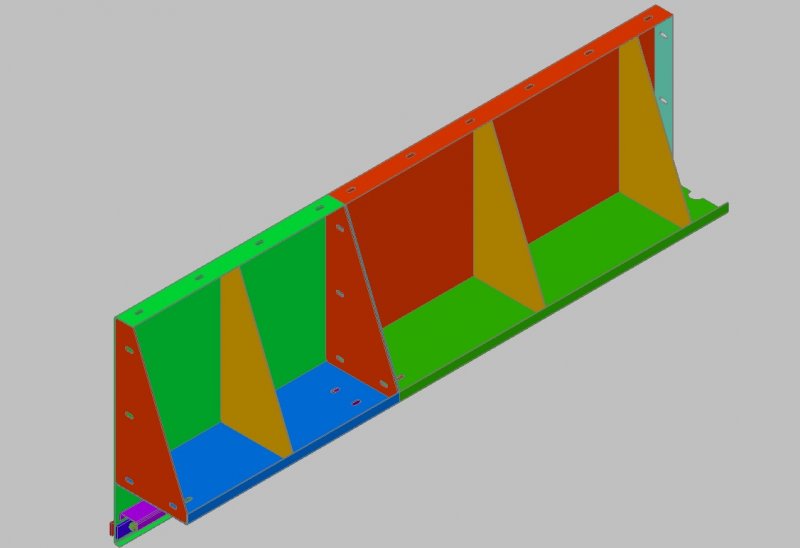

tonyj Posted May 22, 2013 Author Posted May 22, 2013 Here are a couple of screen shots. The one with the block been modified, the red and green assembly, is what the model should look like all the time when in shaded mode. Quote

tonyj Posted May 23, 2013 Author Posted May 23, 2013 Shows up fine here. [ATTACH=CONFIG]42069[/ATTACH] Are you in 'shaded' mode, your image looks like 'shaded eith edges' and what happens when you edit one of the blocks in place. Quote
tonyj Posted May 23, 2013 Author Posted May 23, 2013 I don't know if this will mean anything. But when I 'Write block' any of the parts or blocks to a separate file there is no problem with that file. The 'Part drawing' that I attached was the full model with everything deleted and purged, except of course for the two blocks. Quote
