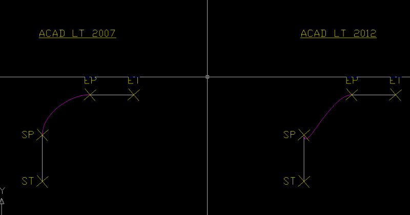

DJB.jpgsee attached picture of spline curve. I find it impossible to duplicate the correct spline curve created simply and correct in lt 2007 within lt 2012. It just not possible.
There must be a system variable set differently also as curv dis[playes differently in 2012 to 2007 even when exact same drawing is opened. In 2012 the curve moves a long way south out of display.

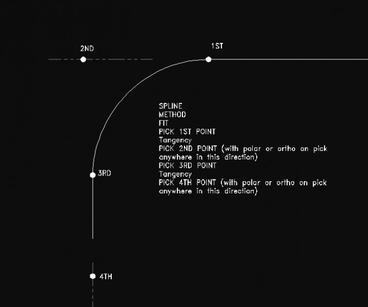

How about this method for drawing it, not sure why it displays differently from one release to another, that sounds dangerous.
Edited by rkent
They did change it on you in 2011
http://heidihewett.blogs.com/my_weblog/2010/05/spline-tangent-direction-in-autocad-2011.html
alternatively when you have picked your starting point, and are asked to pick the start tangency, then you would need to pick a point in front of your spline on an imaginary line extending upwards from your starting point, which you can do using the extension osnap, I hope that makes sense basically in your sketch "ST" would be above "SP" and not below it.
Thanks guys. I have played with this and agree it does appear that you have to point in a different direction for point one. Prefered the old way though as it made more sense and easier to use. I have also tried this way and the spline curv dissappears off the top of the screen and curves back on itself. Opposite to example attached earlier but will not display as rkent detail above. There must be something wrong with my Acad install or a system variable set incorrectly somewhere that is forcing the curve to display incorrectly. It is as if there is a set distance offset. When I draw the spline it extends the first pick point line by a set distance in the direction of the first tangent point before curving back to second pick point. Any idease would be welcome. This is so anoying. Why did Autodesk try to fix something that was not broken?
Pick the first tangent point as the apparent intersection of the two lines rather than a random location.
