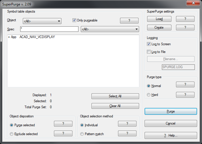

JCYK Posted May 20, 2013 Share Posted May 20, 2013 An unexplained autocad problem has surfaced once again... this time it has created quite a havoc in my office! I would like to appeal for all autocad experts to help solve the mystery please... Here's the problem description: The autocad file size is unreasonably huge (eg. 20MB) even after I've deleted all elements in the drawing and purged. Tried performing audit and recover but with no results. If I try copying a single line from this file into a new drawing file, this new file "gets infected" and became huge in file size as well... and once again deleting the line will not reduce the file size. There's no xref, hidden or freeze layers. One thing I do noticed is when I Purge>View items you cannot purge> Linetypes, it contains loads of unknown linetypes which I don't understand why. Not sure if this is linked to the problem... Hope I can get some help on this... many thanks in advance! ; ) Quote Link to comment Share on other sites More sharing options...

JCYK Posted May 22, 2013 Author Share Posted May 22, 2013 Thanks a lot Remark! Just tried the SuperPurge you mentioned, deleted most of d unpurgeable but it only reduces less than a MB size. If i try purge every item it will delete my drawing elements as well. Do u or anyone knows which items i shoyld not select to purge so that my drawing elements will not be deleted?? It will b a very great help is someone can offer a solution... Many thanks! Quote Link to comment Share on other sites More sharing options...

JCYK Posted May 23, 2013 Author Share Posted May 23, 2013 The latter that you mentioned is definitely not what I'm trying to do as I know that's quite close to insane. I just want to purge whatever is needed to do the job i.e. reduce the file size to normal. Below is the printscreen of the SuperPurge for easy reference. Here's what I've tried: 1. Checked Only Purgeable; Purge Type - normal; Select All : 14 objects purged. 2. Uncheck Only Purgeable; Purge Type - normal; Select All : 0 objects purged. 3. Checked Only Purgeable; Purge Type - hard; Select All : commandline shows "SuperPurge Error ['eNullObjectId' in Spurge.cpp", line 1249]" 4. Uncheck Only Purgeable; Purge Type - hard; Select All : same as 3 above. Kindly enlighten me exactly how should the correct way be done please... Any help is greatly appreciated~ Thanks! Quote Link to comment Share on other sites More sharing options...
ReMark Posted May 23, 2013 Share Posted May 23, 2013 (edited) The procedure I used previously on a problem like this is explained in post #6 of this thread... http://www.cadtutor.net/forum/showthread.php?78944-Bogus-Linetypes-unable-to-purge&highlight=purge If you can't get it to work your only other recourse is to post the file to a site like Dropbox so those of us willing to take a shot at it can download the file that is causing you such a problem. Edited May 23, 2013 by ReMark Quote Link to comment Share on other sites More sharing options...
JCYK Posted May 29, 2013 Author Share Posted May 29, 2013 Thanks for the info ReMark! Can I ask you in your appended thread you exported the cad dwg to V8 Microstation .DGN file. I tried that and in the pop up dialogue box there's a section "Specify seed file" where I'm suppose to select a DGN file. And if I don't select any it can't proceed. What is this seed file exactly? Any DGN file? As I only uses autocad I will not have a dgn file, unless I try download one maybe... Btw I've just learnt of another solution to the problem and would like to share here: 1. Open the heavy cad file; 2. DXFOUT; 3. Open a new cad drawing, DXFIN; 4. Purge, -Purge (Regapps), audit and saveas. The file size was reduced tremendously! ; ) Quote Link to comment Share on other sites More sharing options...
