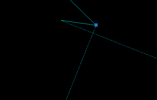

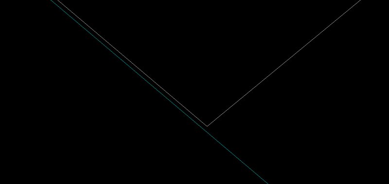

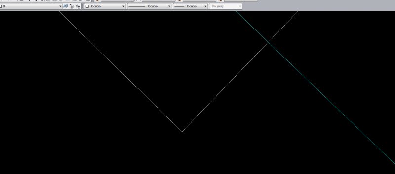

Hello. I use autocad 2010 x64 and have strange problem.
I often check nearby polylines for intersection, so i zoom to see ~0.001 meters distance between them, when they have ~200+ meters length. Zoom goes well until some level, then they suddenly changes their position, angle; if one of them is selected, then even some artifacts appears
