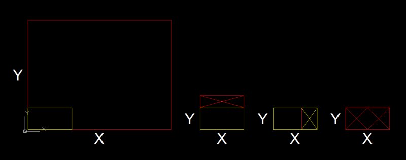

Hogfan Posted May 20, 2013 Posted May 20, 2013 I am sorry to be asking but, i have a 2D drawing that is drawn if full scale, it is 26feet wide apprx. and 20 feet tall. I need to scale down to fit on a 4 X 8 for a mockup, i have tried using the scale command, but to no avail. I am sure it is something simple, but i am self taught for the most part and really need some help on this, as i have to turn out this mock-up within next day or so... Thanks to all, i have always gotten good help from everyone on here. Quote

Hogfan Posted May 20, 2013 Author Posted May 20, 2013 Yes, it is 8ft. in horizontal. i used the scale and went to .33 and the part comes out to 102.875", but the height is not changing enough ( 78"), it is real close. i will keep working on it. What do you mean by using a different x/y scale? I will post the dwg of what i am doing and what i have done, maybe that will clarify. Quote
ReMark Posted May 20, 2013 Posted May 20, 2013 8/26 = 0.3076923076 4/20 = 0.2 Mean anything to you? Quote
ReMark Posted May 20, 2013 Posted May 20, 2013 We don't need to see the actual drawing. If you make a block of the larger rectangle and then insert it into the smaller rectangle and uncheck "scale uniformly" you can apply a different scale factor to both X and Y and the larger rectangle will fit perfectly within the confines of the smaller one. Quote
ReMark Posted May 20, 2013 Posted May 20, 2013 This is what I come up with. The rectangle on the far right has been inserted as a block and non-uniformly scaled. Perfect fit. Quote
ReMark Posted May 20, 2013 Posted May 20, 2013 While that may seem like a workable solution remember that it will distort whatever is represented by the larger rectangle. If you can live with the result then fine. If you can't then you would be faced with a choice of either having some extra (non-filled) space or changing the final size from 8x4 to something more suitable scale-wise. In the future, should you have to do something similar, save yourself some work by using this quickie proportional scale calculator... http://scriptygoddess.com/resources/proportioncalc.htm Quote

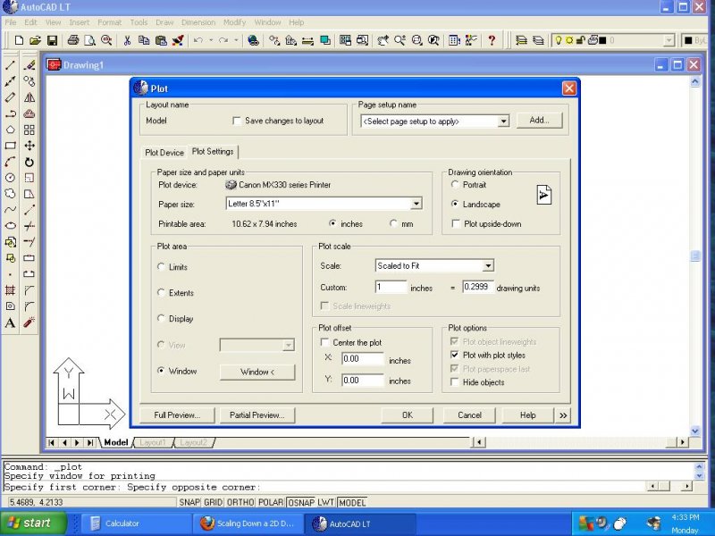

welldriller Posted May 20, 2013 Posted May 20, 2013 ReMark do you think it would work to choose PRINT from the pop-up window choose WINDOW draw a window around the drawing and under the plot scale choose FIT and print it out on a 8-1/2 X 11 and then trace it on what ever he wants it on. Quote
ReMark Posted May 21, 2013 Posted May 21, 2013 welldriller: I would not consider that a viable option as Hogfan wants to fill the entire area. AutoCAD is not going to make it magically proportional. Some intervention on the OP's part is required thus my suggestion re: block and different X/Y scales. Quote
welldriller Posted May 21, 2013 Posted May 21, 2013 (edited) Thank you for the reply ReMark, just thought it might be a start to something useful Edited May 21, 2013 by welldriller correct spelling Quote
