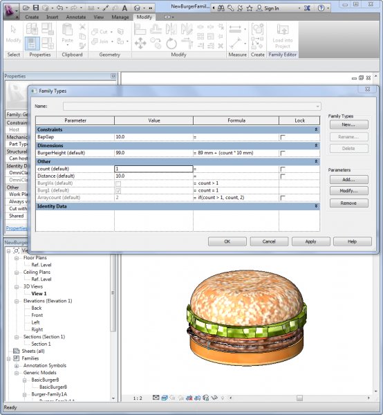

Hoping someone can advise, I currently have a working parametric family where I have set up an array to add additional items within the component and realign everything as the numbers increase or decrease.
The problem I have is I want to be able to reduce the multiple elements from one to many but using the array I always have at least two, reducing to one creates an error report, is there another approach I should use to achieve this?

I have followed the details closely and I'm soooo close to getting it working but when taking the family into a proj and changing the count to 1 I get:
There are identical instances in the same place. This will result in double counting in schedules.
...and my schedule lists 3 elements instead of 1, change the count to 2 and all is good, for some reason I can't fathom, the array is not switchiong off as it shows in the parameters:
Don't ask why I'm modelling a hamburger it's too painful to discuss.
Any ideas what I'm doing wrong?
For anyone interested:
...I eventually managed to get this to work, I had to set up the nested array family to hold the visibility/count settings described above and link them in the master family and redefine, somewhat complicated but it works :D
