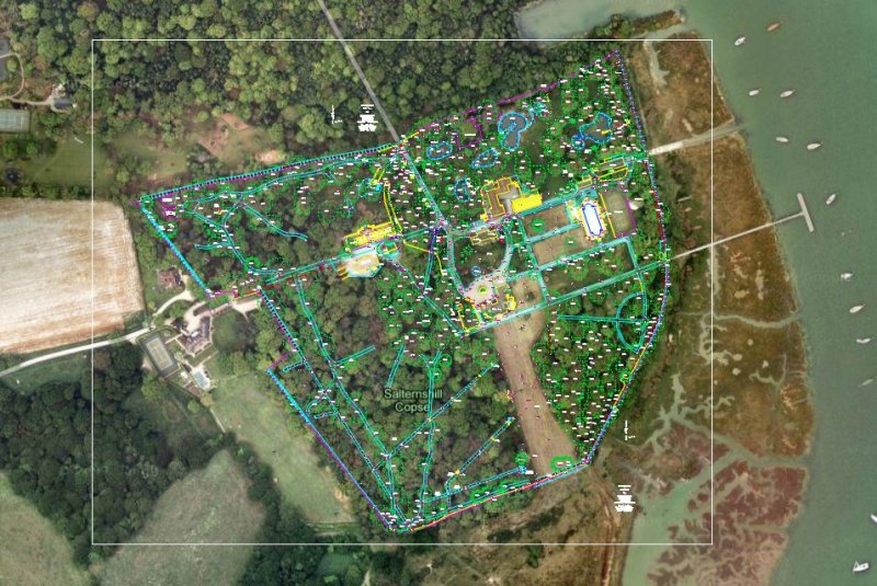

I expect that you have uploaded your drawing into the cloud. Is it Georeferenced? My drawings are not, so I had to manipulate Google Earth to look at my location. The imagery date is given, so you can see how up to date it is.
Once I had found my location, I zoomed in to the detail, and I don't know what I actually did, but Google Earth rotated and scaled a bit, so that the detail fitted.

You could use a screen shot of the google map image and insert into AutoCAD or use Photoshop/Illustrator to place the AutoCAD info onto the google earth information or use any one of the methods previously mentioned.

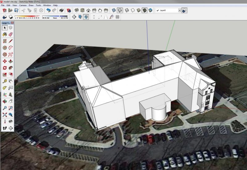

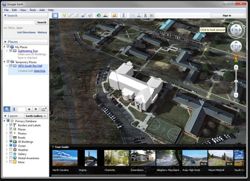

What about SketchUp? You can use the Geo-Location tool to grab the area in question. Then import your dwg file or model. Align and then export to a kmz (Google Earth) file. Would this work? Of course you will need the pro version to import the dwg file.
Hint: You can still get the v7 free version and the dwg import tool to use for your dwg importing. Then open in the current version and do the work.
Update: Seems to have worked very well in Google Earth.
