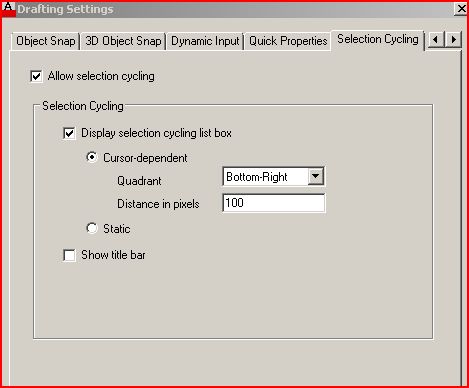

guran Posted May 15, 2013 Posted May 15, 2013 Press Ctrl+W to turn Selection cycling off and on Quote

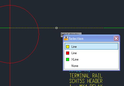

MSasu Posted May 15, 2013 Author Posted May 15, 2013 For example, if I have 3 overlapped lines, when pick on top of them I get this list instead of just having top one selected: Quote

MSasu Posted May 15, 2013 Author Posted May 15, 2013 Press Ctrl+W to turn Selection cycling off and on That it! Thank you very much, Guran! Quote

dbroada Posted May 15, 2013 Posted May 15, 2013 Here I have already selected Yellow and can now go back in and select Red. Then press space and the yellow and red will move. Quote

dbroada Posted May 15, 2013 Posted May 15, 2013 lets try again... draw 3 lines, Red, Yellow & Green. hover over the lines and when blue icon appears click the top line. The Selection box appears. Select one line in list and the list disappears but your selected line is still selected. This can be moved independantly using the grips. or hover again to select another item from the list. I don't get the list up if I grab a grip but get the list if I grab the line. Does that help? Quote

neophoible Posted May 15, 2013 Posted May 15, 2013 Press Ctrl+W to turn Selection cycling off and onguran, thanks for this. I hadn't thought about such an option. Note that this toggle will work in the middle of selecting, that is, once you have the objects you need, you can toggle the Selection box off and continue as usual, which means you do not have to go for a grip in this case. BTW, this feature exists in 2012. I don't know how far back it goes. Quote

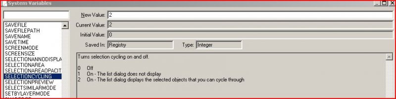

Dadgad Posted May 15, 2013 Posted May 15, 2013 I really like using selection cycling, usually have it on. Quote
MSasu Posted May 15, 2013 Author Posted May 15, 2013 If someone was to find the system variable controlling this behavior, that one could be anyone but the Master of System Variables, aka Dagdad! Thank you! Quote
