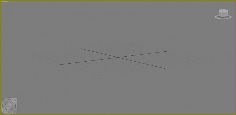

1. How do you remove the square-gridded plane at the center (please see the attached image), make it disappear?

1. Hit the "G" key on your keyboard.
