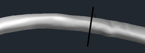

Hi,
I am using AutoCAD 2013
and I am a beginner.
I need your help!
My solid model is imported from IGES file format.
I'd like to make a plane at specified location (perpendicular from the surface),
and I'd like to have a cross sectional geometry cut by that plane.
(attached pic.)
1. How can I make a plane following perpendicular line from the surface?
2. How can I export the cross sectional geometry?
Thank you!

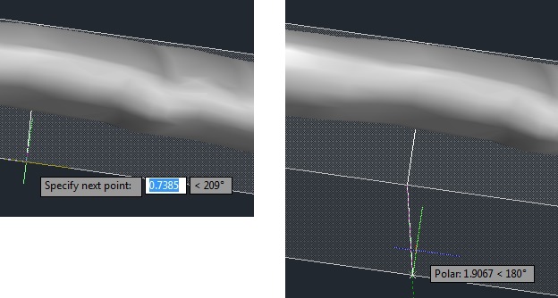

Hi, Yes, I tried to use SECTIONPLANE.
Looks like there are 4 options, 1. select face 2. select points on section line (does this mean cross sectional line?) 3. Draw section 4. orthographic
Then I guess #2,3 options are available....
So I picked "Draw section"
But I don't know how to select-.
First it asks First point,
I'd like to select a certain point but it automatically guides me to select near..point. is there any option to put certain coordinates by manually?
Second, it asks me to select "next point" but I don't understand what 209 and 180 means. and what is the "polar" thing????
I don't know how it generates the cross-section (plane)

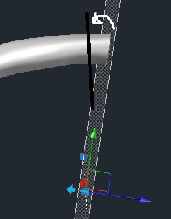

or I made plane using "orthographic" option, but, this plane is not the right angle.
Can I rotate axis in certain angle? , if so how can I ??
