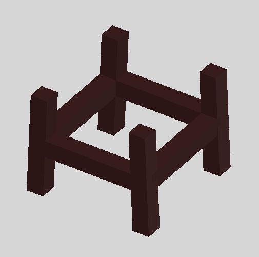

Why is there no distance indicated to the centerline of the transverse section?
Are you attempting to do something like this?
  nicolas said:
....given there is no extrude to face as in inventor, ...Nicolas.
You could Slice in AutoCAD to get the correct length with angles on the cuts.
