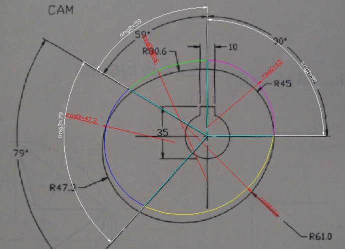

If this works, here's a shot of JD's AutoCAD solution superimposed on a copy of the OP's pic. I tried to line up the angle lines and the camshaft centers. It's not perfect, but it's good enough for a basic visual comparison. Hope this comes out. Sometimes I'm locked out for a day or so after uploading; haven't figured out why yet.Cam Solution Over Prob.jpg

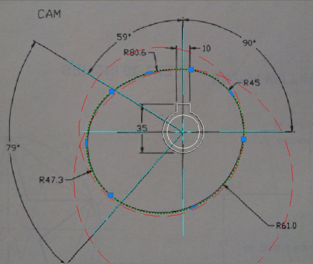

Overlaying Bill T's solution and rotating the profile 7deg CW about the center of the camshaft, you get a pretty close fit, but it's still not right on the money. Of course, neither is my overlaying. I did not rotate the angle lines with the profile, so obviously, they are no longer aligned. As stated earlier, the two that were not right angle, were off anyway once the R47.3 was blended.Cam Solution Over Prob BillT7.jpg
Knowing how AutoCAD defaults to the angle precision set at the nearest degree, I was wondering whether being able to set a plus or minus half a degree to the angles would lead to other solutions.
I do not have the ability to check this out, but it might lead to interesting results.
Yes, the solution is unique when you hold each of the values exactly. You will certainly get a range of results if allowed to vary the angles. However, I am not sure how much of a range of results there would be. The same holds true if you can vary the radial values. That's one of the reasons I mentioned a possible rounding or conversion factor error. If it was originally done in inches and converted to mm, that might account for some of the difference. But, again, I don't know what would be required to bring it into exact alignment.

It doesn't look like there is a smooth transition where the arcs meet in the image shown above. Why is that?
It also doesn't appear to have the same shape as the other solutions JD created. Are the same criteria actually being applied here?
The cam looks "pinched" (for lack of a better word) at each location where one arc is supposed to blend with the next. If that is the math solution then I prefer a couple of the non-math ( CAD ) solutions better.
