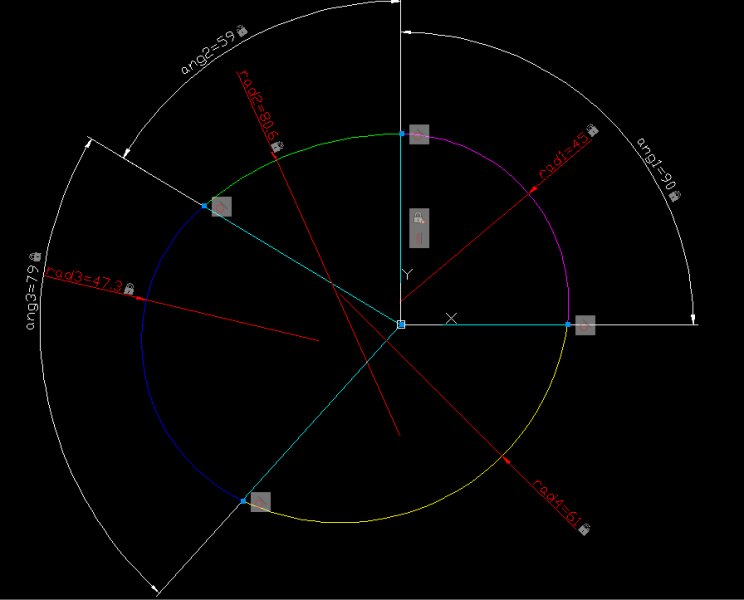

JD Mather Posted May 14, 2013 Posted May 14, 2013 Your "solution" does not appear to be even close to correct. Before all else, you should draw and dimension the angled lines - I do not see these in your solution. (lengths of the lines don't matter for the solution - make them extra long so that they can be used for trimming the arcs as needed) It makes sense to place the vertex of the lines at the origin. As I noted previously - NONE of the arc centers are on ANY of the given lines (nor are they at the origin). That makes it an interesting geometry problem. Quote

neophoible Posted May 14, 2013 Posted May 14, 2013 (edited) Rather obvious that it is a circle at the vertex of the angled lines. (keyway is also trivial).Yes, that's what I said. But the center of it is not trivial, it is key, that is, it is whence the angled lines originate. Without it, they no longer have an origin in the original problem. Or am I missing something? The reason I say this is that, the way I understand this, these angles are not the angles of the arcs, but of the endpoints to the center of the shaft, that is, to the point of rotation. I would have saved down myself, except that parametric constraints are critical to the way I found the solution.Yes, I can see that the parametric constraints are critical. I'm working in 2012, but save down to 2007 format due to work environment constraints. I think that the 2012 parametric constraints are retained when saving, though they may not actually work in 2007. Does anyone know if there are new parametric constraints in 2013 compared to 2012? Edited May 14, 2013 by neophoible added "The reason..." Quote

neophoible Posted May 14, 2013 Posted May 14, 2013 (edited) So JD, can you tell me if I got it correct? I took me less than 10 minutes as well using AutoCAD.Bill, you did it the way I initially interpreted it, which is not correct. If you look at the endpoints of your arcs, they do not lie on the angled lines you drew. As I mentioned to JD, and as he apparently drew it, these angles represent how much rotation each arc sees about the center of rotation of the cam, not the angles of the arcs themselves. BTW, it looks like AARi's microstation solution may be correct and match JD's, but it is very hard to tell. Edited May 14, 2013 by neophoible added note about AARi's solution Quote

Bill Tillman Posted May 15, 2013 Posted May 15, 2013 Bill, you did it the way I initially interpreted it, which is not correct. ... I didn't think it would have been that easy. But what I see when I trim the arcs to the angled lines, I'm left short on the left side with the arc which is 47.3R so if I extend it to the angled line to meet the other arc, the surface does not follow a smooth transistion. Again, I'm no ME and never work with cams, but that would seem to me that your push rod would have a rough time hitting this surface imperfection. Am I off-base on this too? BTW all my arcs end on the angled lines with the exception of the 47.3R line in the upper right portion of the cam. Quote
JD Mather Posted May 15, 2013 Posted May 15, 2013 So JD, can you tell me if I got it correct? I took me less than 10 minutes as well using AutoCAD. I don't see an attachment? Did you look at my solution? Every arc is tangent on both ends. Every arc begins and ends on the lines. (but the centers are not on the lines) Quote

JD Mather Posted May 15, 2013 Posted May 15, 2013 Attached is r2007 version (student license) I have no idea what 2007 will do to the parametric constraints. The radius dimensions point to the centers of the arcs. Cam Solution 2007.dwg Quote

Bill Tillman Posted May 15, 2013 Posted May 15, 2013 If we assume all of the arcs are tangent and they stop/start at the angles given - there is one solution. (none of the arc centers are on any of the construction lines, but it is fully defined with the given dimensions) (BTW - solution was found in less than 10 minutes.) [ATTACH=CONFIG]41871[/ATTACH] JD...I guess there are some assumptions I made which differ from yours. For example, the arc on the right side of the cam which appears to begin at the horizontal construction line and has an angle of 90°. In your solution this arc's center is offset from the construction line by a distance of 6.08 units. I'm not sure I follow how you made this the location of the center of this arc. But I guess it's also a good thing I don't design cams...I'm only throwing my limited experience at this. Still it's been an interesting exercise and judging by the number of responses it peaked the interest of some others as well. And that's what keeps your mind young. Quote

JD Mather Posted May 15, 2013 Posted May 15, 2013 JD... In your solution this arc's center is offset from the construction line by a distance of 6.08 units. I'm not sure I follow how you made this the location of the center of this arc. ..... The geometry constraints located this for me. Doesn't have anything to do with cams or anything other than geometry. I would like to see your solution, but don't see an attachment above. If I get a chance I will make an actual cam (3D) and run Dynamic Simulation on it to find the Acceleration and Displacement Curves (although that is dependant on the follow shape/size which we don't know). Quote

neophoible Posted May 15, 2013 Posted May 15, 2013 BTW all my arcs end on the angled lines with the exception of the 47.3R line in the upper right portion of the cam.Well, that's one way of looking at it. Like I said, your solution looks the same as my original misinterpretation. Here's another way of looking at it: You have a concentric arc for the 45 radius, which does end at the 0 & 90 deg marks. The other endpoints miss. So, one out of four arcs meets the angle criteria. Or, four out of eight endpoints meet the angle criteria. All of the arc pairs are cotangent. But overall, to meet all of the intended criteria, the profile is incorrect, the endpoints do not hit where they must, the arc centers are wrongly placed. However, as a comparison, I think it might be even more interesting if JD also ran this profile through his simulator. BTW, I'm guessing that solving this correctly without parametric constraints might take a very long time indeed. Quote
