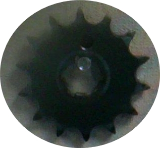

KICK-ASS Posted May 10, 2013 Author Share Posted May 10, 2013 Sorry about the blur in the upper left. IT WON'T GO AWAY!!! (Do you guys need a side view?) Quote Link to comment Share on other sites More sharing options...
JD Mather Posted May 11, 2013 Share Posted May 11, 2013 I appreciate your help, but the reason I came hear was because I didn't know any of those kind of sprocket terms. I think you meant here rather than hear. You never answered my question. Are you really willing to go through this process step-by-step. Can you give me an approximate measure center to center of these arcs (just need a ballpark measurement). Do you have a Machinery's Handbook? If you are a student, is there a reason you are not using Inventor? Quote Link to comment Share on other sites More sharing options...

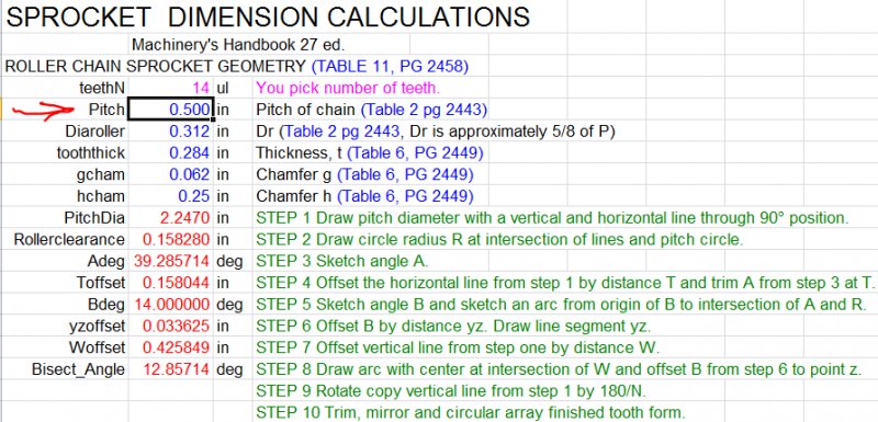

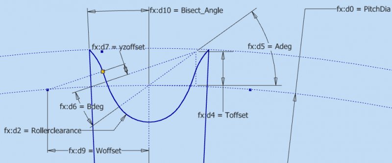

JD Mather Posted May 11, 2013 Share Posted May 11, 2013 If you have a Machinery's Handbook you should be able to find an image very similar to this one. Once you have commited to following the process we can begin. Quote Link to comment Share on other sites More sharing options...
JD Mather Posted May 11, 2013 Share Posted May 11, 2013 Once you give me the approximate distance of the red line shown above on your actual part we can fill in the spreadsheet and calculate our parameters for this sprocket. Quote Link to comment Share on other sites More sharing options...

JD Mather Posted May 11, 2013 Share Posted May 11, 2013 JD, I think he did answer your question, but with a condition. The answer to his condition is, of course, that it DOES need to be step by step. I'll leave it to you to explain why. I missed this response by the OP. My internet is going painfully slow making it difficult to go backwards in the discussion thread (each page takes 5 minutes to load). Sprockets are governed by standardized dimensions as indicated in the Machinery's Handbook. I have set up a spreadsheet for the calculations - so no math is needed (unless the OP wants to dig into the math). The process is fairly straitforward for someone who knows how to draw circles, lines, trim and extend and a couple of rotates of lin Quote Link to comment Share on other sites More sharing options...
JD Mather Posted May 11, 2013 Share Posted May 11, 2013 I just realized that the OP did give an OD dimension for the sprocket earlier that would indicate that it is smaller than a #40 chain. OD is not the best of measurements to go by as the theoretical perfect points are usually cut down a bit becuase they would quickly wair away anyhow. (now all my spelling is looking suspect to me, if my internet was not running so slow I would do a check, but oh well. The best measure would be the pitch, but the thickness is also a pretty good measure (and the easiest) since the thickness is also governed by the standard chain sizes and given in the Machinery's Handbook. (see tooththick variable in spreadsheet image above) Of course manufacturing tolerance and application might vary that parameter a bit, but it shouldn't be too far off and can only go one direction (smaller) as you can't make the chain wider from side to side. Quote Link to comment Share on other sites More sharing options...

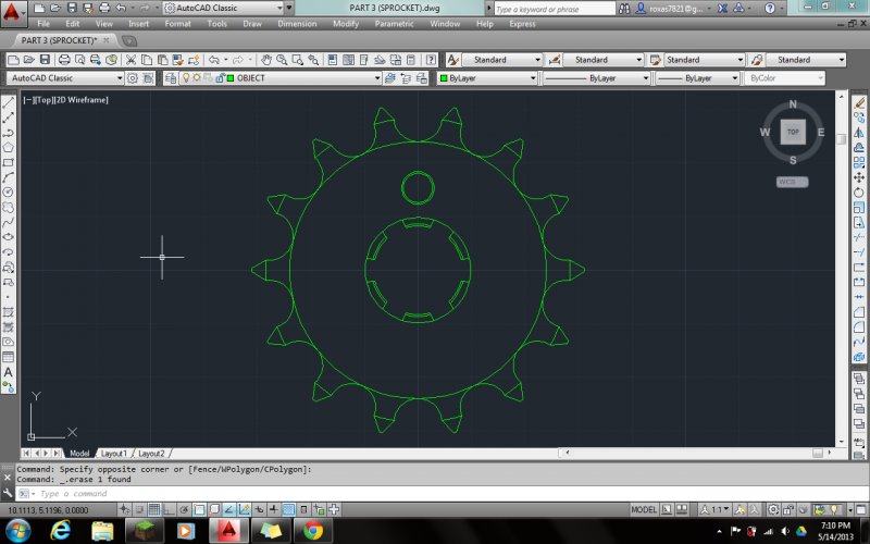

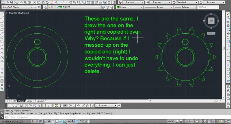

KICK-ASS Posted May 14, 2013 Author Share Posted May 14, 2013 Overall view of progress. This one isn't to important. The image FOLLOWING this post will have a closer view on the copied dwg (read txt in the img) with dimensions. Quote Link to comment Share on other sites More sharing options...
KICK-ASS Posted May 14, 2013 Author Share Posted May 14, 2013 Here is the more detailed one. Let me know if you want a picture of the ORIGINAL one (left side on first picture) with dimensions. Quote Link to comment Share on other sites More sharing options...
neophoible Posted May 14, 2013 Share Posted May 14, 2013 Overall view of progress. This one isn't to important. The image FOLLOWING this post will have a closer view on the copied dwg (read txt in the img) with dimensions. Looks like progress, but does not show any dimensions, nor did you respond to earlier questions. I take it you are feeling more comfortable measuring the sprocket? Quote Link to comment Share on other sites More sharing options...
neophoible Posted May 14, 2013 Share Posted May 14, 2013 Here is the more detailed one. Let me know if you want a picture of the ORIGINAL one (left side on first picture) with dimensions.Again, it looks like a lot of progress. Very blurry, though. Are you showing just dimensions you measured yourself? What about the angle on the tooth? It is really very difficult to make the dimensions out. I feel like I'm looking at it without glasses, even when I'm zoomed in very close. Also, you did not respond to earlier inquiries about your project. Do you understand why JD wanted the dimension you pointed out? When is your project due? Quote Link to comment Share on other sites More sharing options...
KICK-ASS Posted May 14, 2013 Author Share Posted May 14, 2013 Is it really?! (No sarcasm instead ) I'm not sure how it can have blur, considering that I got that by using the "Prnt Scrn" key. (basically a screenshot) Quote Link to comment Share on other sites More sharing options...
KICK-ASS Posted May 14, 2013 Author Share Posted May 14, 2013 I can understand why it seems that I didn't answer his question (you couldn't make out the dimensions), but I used txt box to write "JD!!!" and pointed an arrow to the dimension he asked for. And in case you can't read it (this sentence is talking to JD) The measurement you asked for is 0.63284954 in. Quote Link to comment Share on other sites More sharing options...
KICK-ASS Posted May 15, 2013 Author Share Posted May 15, 2013 However I still need a side view and an Iso view, but I'm pretty sure I got those. If I end up getting stuck on it though, I'll make sure to come back to this thread. (rather not make a new one ) THANK YOU GUYS SSSOOOO MUCH FOR ALL YOUR HELP!!!!! Quote Link to comment Share on other sites More sharing options...
