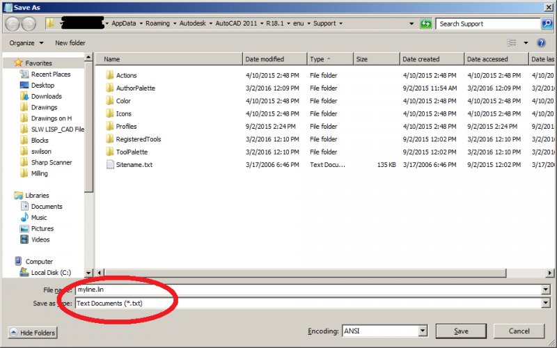

Doneaux Posted March 2, 2016 Share Posted March 2, 2016 OK, I'm right at the door, but I can't go in yet. I've got the folder open in Explore and after the last folder ...\support\\, there is no .lin folder. There are .lin files in the support folder. So how do I convert a .txt file (the saved plain text line) over to a .lin file. Where is the conversion made if I were to save directly to the support file? If I open the file path in Word, none of the files under Support show up. Quote Link to comment Share on other sites More sharing options...
SLW210 Posted March 2, 2016 Share Posted March 2, 2016 Save as Myline.lin where Myline is the name of your line file. Quote Link to comment Share on other sites More sharing options...
ReMark Posted March 2, 2016 Share Posted March 2, 2016 I never said there was a .lin folder I did say, however, to look for aclt.lin. So, did you find it or not? If you did then open it using Notepad or Wordpad and append your linetype definition to the bottom of the file. It clearly states where user defined linetypes must be added. Put your definition anywhere else in the file and it won't be recognized. Quote Link to comment Share on other sites More sharing options...
