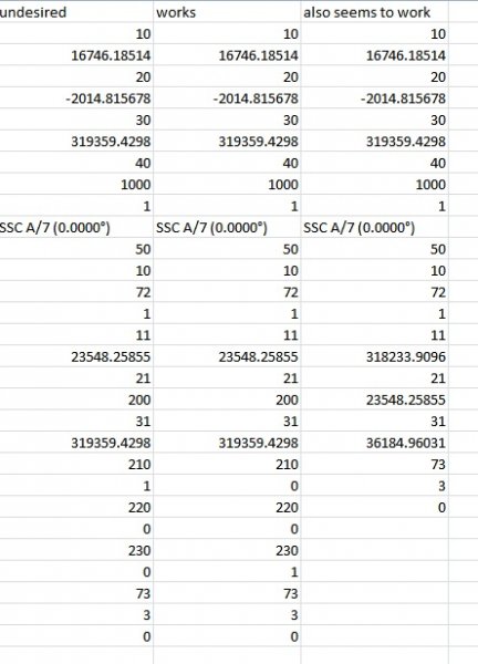

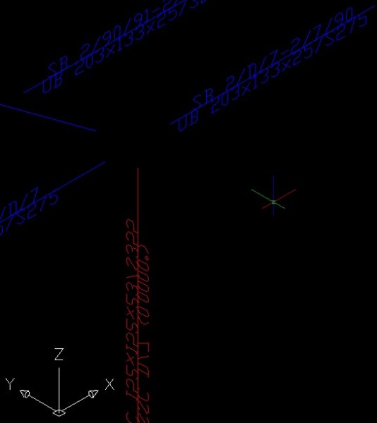

chris2012 Posted May 7, 2013 Posted May 7, 2013 (edited) I am looking to rotate multiple text entities about their own individual insertion points to an orientation legible in plan view. This is not a simple matter of changing the angle of rotation as this rotates about the wrong axis (and of course multiple items)! Through experimenting with dxf codes I have established that if codes 210,220 and 230 are set to 0,0,1 then this does achieve the desired result. i.e. (210 0.0) (220 0.0) (230 1.0) The reason I am doing this is to format text output from another drawing package. I have found and am trying to modify the attached Lee Mac "change colour" lisp to achieve the result highlighted above and would be greatful for any help from the collective on this. Note that I alighted on this code as it adds the desired entities if they do not originally exist. Thanks in advance for any help \ pointers Chris (defun c:doit (/ i ss ent eLst) (if (setq i -1 ss (ssget "_:L")) (while (setq ent (ssname ss (setq i (1+ i)))) (setq eLst (entget ent)) (setq eLst (subst '(8 . "0") (assoc 8 eLst) eLst)) (entmod (if (assoc 62 eLst) (subst '(62 . 3) (assoc 62 eLst) eLst) (append eLst '((62 . 3))))))) (princ)) Edited May 7, 2013 by SLW210 Added Code Tags!! Quote

chris2012 Posted May 7, 2013 Author Posted May 7, 2013 lightning fast Alan thanks. I have had a look at your link but this is not what I'm after. Have posted a screen grab to show the orientation of text. Quote
chris2012 Posted May 7, 2013 Author Posted May 7, 2013 Alan Thanks for this, I have had a detailed look at your lisp and (as I understand it) it appears excellent at addressing the rotation variable (code 50) associated with an entity, however it does not appear to address the rotation about the other two axis. In aircraft jargon if rotation could be thought of as roll, the rotations I am interested in are pitch and yaw. I don't suppose you would be interested in updating your code to account for this????? Chris Quote

chris2012 Posted May 7, 2013 Author Posted May 7, 2013 Excellent job Lee, thanking you ! The second program works just great. For the icing on the cake (and with reference to the screen grab above what would be really excellent if the text could be rotated around the line going through it. i.e. the blue text (beams) would be rotated about the blue line (x direction) so it is visible when looking down from the z direction. the red text (columns) should be set to 45 degrees on plan but I can manage this from what you have given me. If you could afford any more time with this it would be brilliant! Chris Quote
