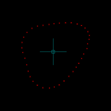

I am using vanilla AutoCad (R14-2012) and was wondering what the best solution would be for this problem (other than manually drawing each outline which I currently do!)
I am looking to draw polylines along each point creating a polyline outline (perimeter) around the selected points. This in itself is quite difficult to do well(haven't found a great method yet) but there are multiple groups of points that I would like polylines around without selecting each individual group of points (in an ideal world).
I realize that getting something 100% right is impossible and some manual editing (maybe a lot!) will be required.
Attached is a sample of the points I usually have to work with.

2. Convex Hull (Lee Mac ftw)

3. Create surfaces out of points using triangulation and limit the length of triangle then use bounding box to create polyline(hard to do in vanilla AutoCad).

This sounds like something better done a step earlier by using points codes xyz & description "join like" descriptors this is known as stringing CIV3d etc its built in.
I have a program that will generate an LWPolyline outline for a selection of points in the plane, as demonstrated by the following animation using some examples from your file:
As expected for this form of task, the program does not return what would be considered the 'correct' outline for some point arrangements with tight concave sections, however, the algorithm should produce good results for most general cases.
The program is not freeware however, and you may contact me if you are interested.
