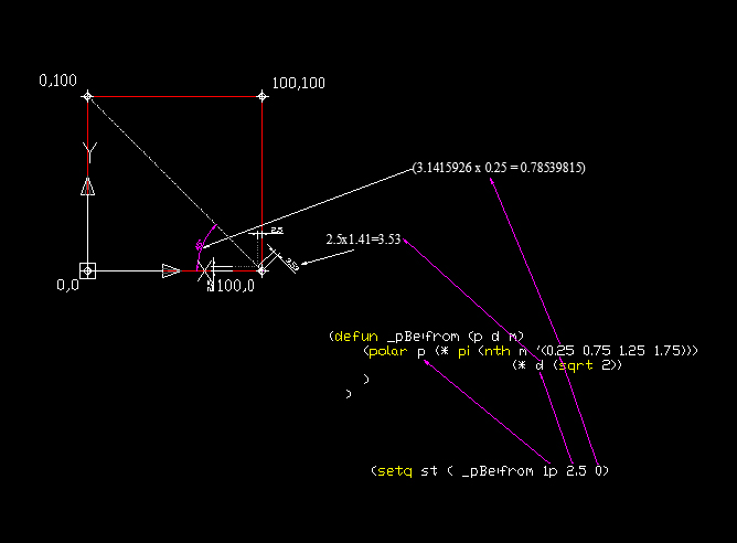

this time ill ask you if i understand visually
(setq st ( _pBe:from 1p 2.5 0)
             objrot (ssadd)
             tr 0)
       (setq l1 (list (polar st (/ pi 2.0) 100) st
                             (setq 3p (polar st 0 (- h 5.0)))
                             (polar 3p (/ pi 2.0) 100)
             l2 (list (polar st 0 100) st
                             (setq 3p (polar st (/ pi 2.0) (- v 5.0)))
                             (polar 3p 0 100)
the target function
(defun _pBe:from (p d m)
   (polar p (* pi (nth m '(0.25
0.75 1.25
1.75)))
(* d (sqrt 2))
