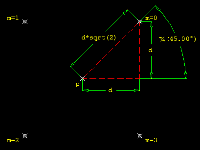

(defun _pBe:from (p d m)
   (polar p (* pi (nth m '(0.25 0.75 1.25 1.75)))
                    (* d (sqrt 2))
i didnt see any list with the name "m" , i dont get why you need sqrt of 2? and what those nums 0.25, 0.75.1.75?

m variable is the index number for the value to be use as a multiplier for pi to derive the angle i want the point to project to.
(nth m '(0.25 0.75 1.25 1.75)));-- if m is 2, you'll get 1.25 where (* pi 1.25) is the radian equivalent of 225 degress.
Depending on points selected, you need to set the conditions [angles/distance] for polar arguments.
(* d (sqrt 2))
Isosceles right angled triangle:
One right angle
Two other equal angles always of 45°
Two equal sides
Ratio 1:1:√2
Say vertical/Horizontal distance is 2
2x√2 will give you the length of Hypotenuse
(* d (sqrt 2);

hello Patrick
i understand that the following function the final coordinates before you send it to entmakex() but i dont understand the math.
                    (* d (sqrt 2))
                    (* d (sqrt 2))
Perhaps the following image will help to explain the function parameters:
thanks LEE
i think i got it
(i think P and m=0 should be at the same location???)
define a point that is (3.1415926 x 2.5 = 0.78539815) in its angle, and (2.5 x (sqrt 2 = 1.414213562373095) = 3.535533905932738) units
its defines the corners of the rebars
so i can describe this function as a function to define offset point in a square fashion ?
where and how pbe took 0.25 0.75 1.25 1.75? are they constant too?
As Lee already pointed out with an illustration
It gives you the coordinates from a given point with distance and index number as argument.
So with this line
(pBe:from point1 2.5 0)
(polar p; <---- given point [in this case point1 assigned to variable p
      (* pi
  (nth m ; <---- index number [in this case 0 is assigned to variable m
       '(0.25 0.75 1.25 1.75) ;<--- index number 0 i=on this list is 0.25
           ;<--- 0.25 X pi will give you the radians value of
           ;<--  0.785398 equivalent to 45 Degrees
;; Note: you can use the value 0.7853981633974483 in place of that, but
;; for higher precision we used math (* pi num)
;; you can write it the way you want, even (/ pi 4.0)
       (* d (sqrt 2));<-- now for the distance
              ;<-- 2.5 is assigned to varable d
              ;<-- by using this you will be able to determine
              ;<-- the vertical and horizontal distance d from point p
You can however use any of this to get the same result
(setq p1(polar p 0 d) p2 (polar p1 (/ pi 2.0) d))
or
(setq p1 (polar p (/ pi 2.0) d) p2 (polar p1 0 d))
or
(setq p1 (list (+ (car p) d)(+ (cadr p) d) (last p)))
But that is just for one direction: so the other way around would be 135 degrees
(setq p1(polar p pi d) p2 (polar p1 (/ pi 2.0) d))
or
(setq p1 (polar p (/ pi 2.0) d) p2 (polar p1 pi d))
or
(setq p1 (list (- (car p) d)(+ (cadr p) d) (last p)))
As you can see there are too many variables and arguments to keep track of:
(setq p1 (list (arg1 (car arg3) arg4)(arg2  (cadr p) arg4) (last arg1))
Also this:
(* d (sqrt 2))
can also be written as
(polar arg1 (* pi arg2;<--- 0.25 for ex.
(* arg3 (sqrt 2))
(pBe:from point1 2.5 0.25)
Got it?
Kudos to LM :thumbsup: for the illustration
...its defines the corners of the rebars......
Yes it does :)
You can llok at it that way yes.
......where and how pbe took 0.25 0.75 1.25 1.75? are they constant too?
Look at first couple of comments above....
Lee... Are you really a Quantum Mechanic ?
Then that makes forum deity as my occupation then :D

You got it all mixed up Shay.
First argument is a point coordinate (p d m)
2nd is the Horizontal and Vertical distance from first argument [a point coordinate] (p d m)
3rd is the index number (p d m)
further demonstration:
(defun C:demo (/ lst pl)
 (setq pl (car (entsel "\nSelect Pline:")))
 (setq lst (makeCrdList pl))
 (foreach pt lst
   (foreach itm '(0 1 2 3)
     (command "_point" "_non" (_pBe:from pt 2.5 itm))
see what happens.

No, the parameter p is the base point for the polar function and with the index parameter m set to zero, the angle argument of the polar function will be π/4 radians (45 degrees) returning the point as correctly indicated on my diagram.
Please study the documentation on the polar function:
http://exchange.autodesk.com/autocad/enu/online-help/browse#WS1a9193826455f5ff1a32d8d10ebc6b7ccc-6985.htm
Personally, I would use:
(mapcar '+ p (list d d))
