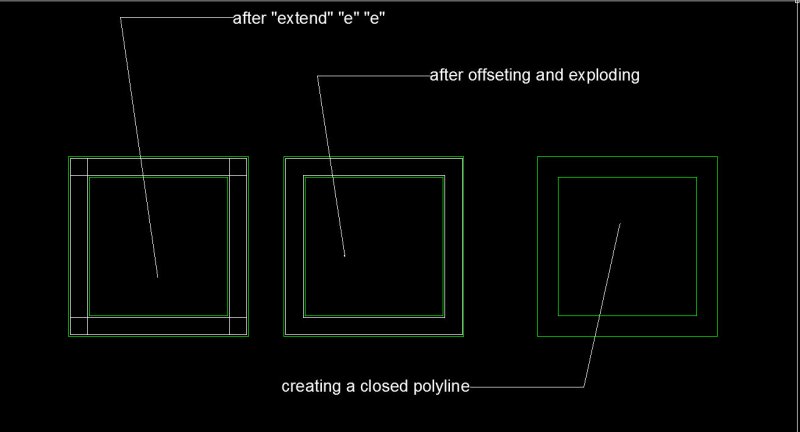

I have an intersection rebars lines in which I need to extend. I painfully repeating this task by “Extend" E” “E” all intersection points
How can I extend all selected lines ? and how I can limit the projection ?
I need my routine to do the following
  1. Pick a closed polyline
  2. Offset 3 units inward
  3. Move the offset line to a layer named “CONS”
  4. Explode the polyline into lines
  5. Extend all line (consider lines in “CONS” only and/or don’t project more than x units)
in the image the steps i take right to left
Thanks

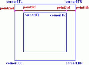

Considering the notation from sketch below:
(setq point1st (polar pointITL (* 0.5 pi) theGap)
     point3rd (polar pointITR (* 0.5 pi) theGap))
(setq point2nd ([color=blue]inters[/color] point1st point3rd pointETL pointEBL nil)
     point4th ([color=blue]inters[/color] point1st point3rd pointETR pointEBR nil))
I see now.
(inters point1st point3rd pointETL pointEBL[color="blue"] [b]nil[/b][/color])
Ok, i'm sold.
Cheers MSasu :)

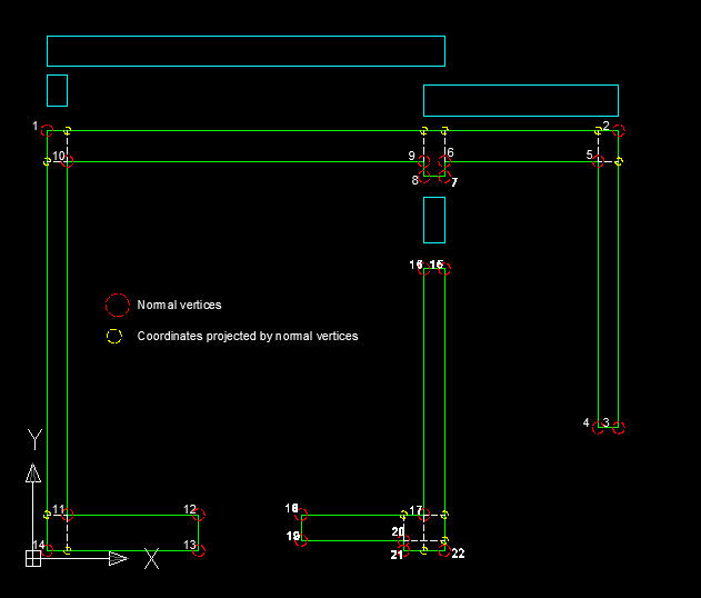

PbE , your code works perfectly for rectangle only, im after a structure level solution
here is a sketch (also dwg included)
i want to extract rebars copy also beside the walls,
se if ill find a way to collect verts 1 and 10 i can extract the rebar of the column,
and if i collect verts 1 and 6 i can generate rebar for this portion of the wall
the yellow circles are coordinates needed to generate rebars that cannot be extracted be normal vertices m like the rebar of 6,7,8,9 , in order to extract it i need to get a projection of 6 and 9 (as MSasu gave me food to think)
hope it make sense
is there a way to code it?
Thanks
Shay
points.dwgFetching info...

i gave lots of thinking, the solution i come to is to draw the rebars in the order and the direction it was drawn
please look at the attached image as it show what im after
here is my pseudo code
Loop
 Go to p1
 Select all surrounding  points in 50 units radius
 If members count is 2 (can be a wall end or a column)
                 Measure distance between p1 p2 aka ”dis” (if it’s a column  or wall end the range is 10-35
                 if “dis” is greater than 100 (it’s a wall)
                                 Draw line from p1, in angel of p2, 100 units
                                 Draw line from p2, in angel of p1, 100 units
                 If “dis” is smaller than 100
                                 Draw a line from p1 to p2
 If member count is 4(for situation where vertecis are not defined (like vers 6,7,8,9)
                 Project lines to all possible direction
                 Draw lines between returned coordinates
what you think?
