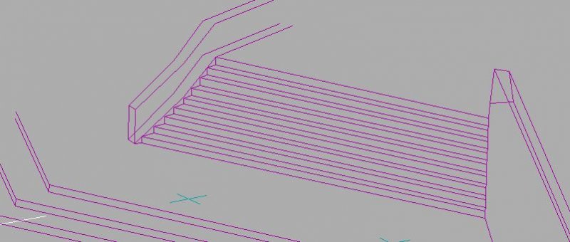

eldon Posted April 30, 2013 Share Posted April 30, 2013 I have a survey, and created a ground model which consists of points and lines, both in 3D in AutoCAD. The Architect has Revit (don't know which version). Can he import my AutoCAD ground model? At the moment we have found out that he says that Revit cannot use either the 3D points or the 3D lines, but it can use 3D blocks. Can anyone suggest a way forward? He needs to create the ground model in Revit. Quote Link to comment Share on other sites More sharing options...

eldon Posted May 1, 2013 Author Share Posted May 1, 2013 Thank you very much for your generous responses StykFacE and Lee Roy. The original survey file is good in parts, but because of various excuses, I had to do a lot of editing. There were some steps and I had to ensure that the nosing of one step did not overlap the back of the next step down. I had to invent a few points which were measured with a tape on site, so the csv file would not give the whole picture. And I don't have access to Data Extraction. What puzzles me is if I put a 3D block on the end of each 3D line, how does Revit know to join the points that I want joined? Anyway, here is a drawing file that contains only points and lines. The site is a beach, sea wall and road behind. It is not Geo-referenced, and the surveyors hand compass is none too accurate! I expect that I will be putting blocks onto the ends of lines (there are only 500 or so lines, so I will be finished by coffee time), but I would be very grateful if there is an easier way. Eldon3DGroundModel.dwg Quote Link to comment Share on other sites More sharing options...

eldon Posted May 2, 2013 Author Share Posted May 2, 2013 Having been spurred on to insert blocks, it is now possible for me to use the Attribute Extraction tool, and get a .csv file very easily. I attach it in case someone wants a bit of data to try out. Eldon-3D data.csv Quote Link to comment Share on other sites More sharing options...

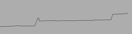

eldon Posted May 2, 2013 Author Share Posted May 2, 2013 Thank you very much for confirming that the Architect will be able to see the data. What a shame that all my work in connecting the points in the right fashion seems to not translate. Anyway, that should keep him busy. No problems about the mistaken identity. I always try to keep my head below the parapet. Quote Link to comment Share on other sites More sharing options...
eldon Posted May 2, 2013 Author Share Posted May 2, 2013 I thought that I would take time to put it into LandDesktop, and this is how a cross section should look like. Quote Link to comment Share on other sites More sharing options...
tzframpton Posted May 2, 2013 Share Posted May 2, 2013 This is what I show: https://dl.dropboxusercontent.com/u/4989089/Images/cadtutor/2013-05-02/Capture2.PNG Quote Link to comment Share on other sites More sharing options...
