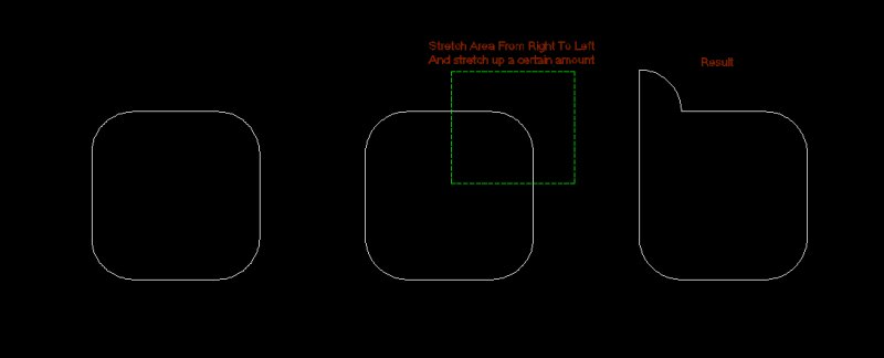

I now have a new PC with AUTOCAD 2010. Since the upgrade my stretch command seems to act differently.
If i go to stretch a polyline with some sort of arc joined. no part of the arc inside the window will move.
Please see the picture atatched for better detail.
Why does it now stretch in this manor?

I have noticed if i draw a rectangle fillet the corners and stretch i have no issue.
Now if i have two seperate polylines perpendicular to each other and fillet the point they meet, or draw an arc in the corner trim and join i end up with the strange result.
if i have one polyline drawn as one. one vertical one horizontal
and fillet it works fine.
it seems to me that it is when two seperate polylines are joined and an arc is involved it works incorrectly.
