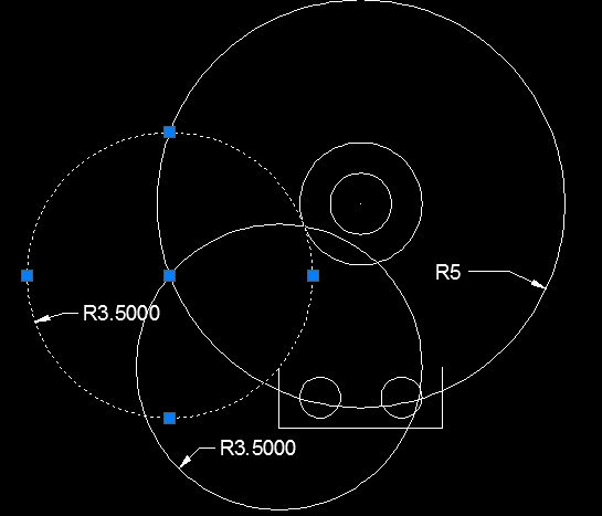

drawing a circle that is tangent to another circle and passes through an endpoint
I was wondering the best way to draw a circle that passes through an endpoint of a line and then is tangent to another circle above it? I need to create a radius of 3.5 between the two points. I will try to attach the picture
Engelhaupt_SensorMount.dwgFetching info...
ok I did that no how can I trim the upper R3.5 so that the only portion remaining is what is between the top circle and the verticle line? I tried to trim it, but it says that it needs to intersect twice. Thanks for the help on the circle
Trims fine for me?
Attach your new file here.
Did you pick both the vertical line and the circle as cutting edges for trimming the arc?

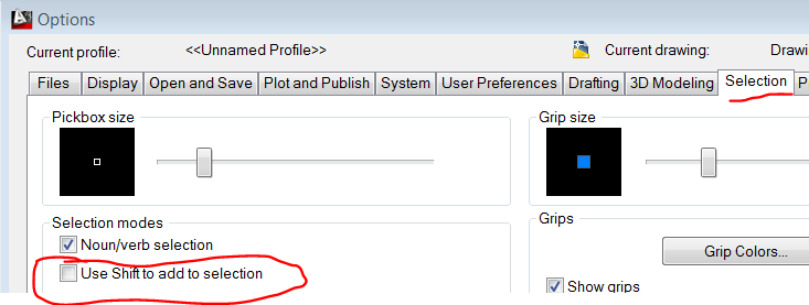

I am not sure what is going on. Could something not be set up right in AutoCAD? We had a computer in class that wouldn't trim right and the professor had no idea what was going on he had never seen anything like it. Thanks for your help.
Never mind I got it figured out, I had to push shift while I selected the second one. I have never had to do that while at class, but for some reason I need to do it on my laptop at home.
Thank you for your expertise. I should buy you a beer. I am getting too damn old to figure this stuff out.
  • 5 months later...
  JD Mather said:
See attached.
[ATTACH=CONFIG]41648[/ATTACH]
Can you pleas explain how you got this?
EDIT: Looked at it a little longer.
Does this work because the 2 reference circles are 3.5 in from where they touch?
