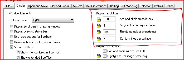

If you look at the image you will see that you can make some prliminary adjustments in your OPTIONS on the DISPLAY tab.
Should you want to learn a great deal about how Autocad works you can invoke the SYSVDLG command which will take you to the inner sanctum.
You might want to save your current .SVF (find the button in the bottom of the SYSVDLG box) before you start monkeying around however, as insurance, should you get your settings into an undesirable state, and want to restore your previous settings. It would be a good idea to keep a list of any variables which you change to help you remember, and assess their various options.
