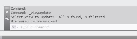

43st Posted April 26, 2013 Share Posted April 26, 2013 Has anyone experimented with rebuilding viewbase views? I have a drawing with unresolved views and I'm not sure how it happened. On a semi-related note.. Does viewbase based sheet layouts make Autocad more unstable for anyone else? Quote Link to comment Share on other sites More sharing options...

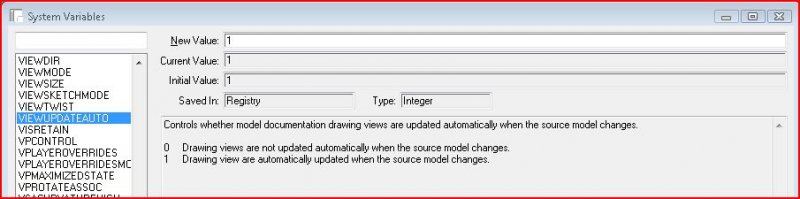

Dadgad Posted April 26, 2013 Share Posted April 26, 2013 By unresolved, do you mean it has not AUTO-updated? That is an option which is controlled by the VIEWUPDATEAUTO variable, as described in the image. Quote Link to comment Share on other sites More sharing options...
43st Posted April 27, 2013 Author Share Posted April 27, 2013 This is what I'm getting.. I see the view, but the scale dropdown is missing and I can not select any function to modify or update the viewbase view. I think I screwed up the file.. I was just wondering if anyone has seen this. EDIT: this is interesting.. Quote Link to comment Share on other sites More sharing options...
Dadgad Posted April 28, 2013 Share Posted April 28, 2013 I've not used it very much, but I have not seen that before. The entities are still in modelspace, right? Is the red perimeter highlighting around the views to indicate that they are not current? Quote Link to comment Share on other sites More sharing options...
43st Posted April 29, 2013 Author Share Posted April 29, 2013 The entities are still in modelspace, right?Is the red perimeter highlighting around the views to indicate that they are not current? Yes and yes.. Quote Link to comment Share on other sites More sharing options...
Dadgad Posted April 29, 2013 Share Posted April 29, 2013 The great thing about VIEWBASE is that you can replace it in a few seconds, if need be. We would be happy to look at it if you can post it, does sound strange. Quote Link to comment Share on other sites More sharing options...

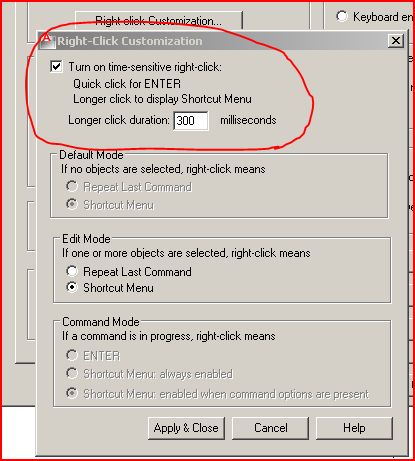

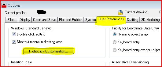

Dadgad Posted April 29, 2013 Share Posted April 29, 2013 For fabrication I just merge those layers into my regular layers, so at the end of the day I show no PV or PH layers, but I understand where you are coming from. I really like TIME SENSITIVE right clicking, because you can use the right click for enter, without losing all of the very useful things that come in the right click menus. You can set it up in your USER PREFERENCES tab, and adjust the time setting to suit your own taste. Viewbase was made appreciably better in 2013. Quote Link to comment Share on other sites More sharing options...

Dadgad Posted April 30, 2013 Share Posted April 30, 2013 Oh, sorry, I meant on the paperspace layout tab, as shown in the image. If you have right hand short cut menus enabled there are a number of options there. I strongly suggest that you give time sensitive right click a try for a few minutes. There is so much available in the right click shortcut menus which you are forsaking to be able to ENTER with your right click. You can have it all, there is no reason, nor advantage to settling for less. Quote Link to comment Share on other sites More sharing options...
43st Posted April 30, 2013 Author Share Posted April 30, 2013 Ok, thanks guys. I gave the "Export Layout to Model" a shot and it crashed. I do not have time for it now, but I'll investigate shortly. Dadgad, I know what you mean about the time sensitive right click. I sometimes have to turn the right click menu on to get to certain features. The problem is if I have something selected, or if I'm in a command the time sensitive part is forgotten by AutoCad and it will pop up always on right click. For example select a line and right click to repeat the copy command, the menu will pop no matter how much you delay the time sensitive part. Not cool. Quote Link to comment Share on other sites More sharing options...
