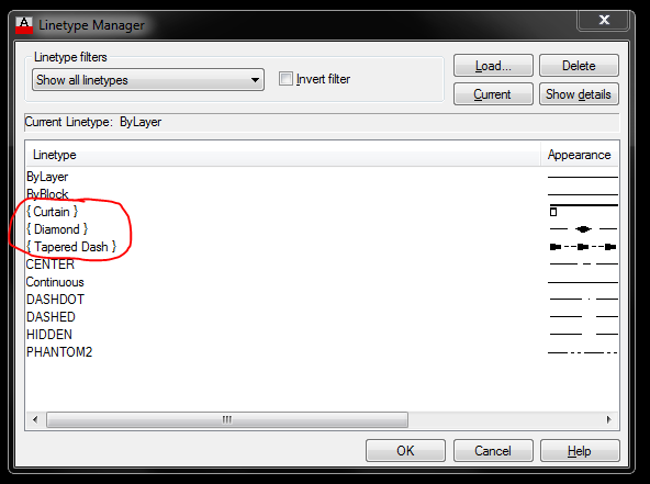

3dwannab Posted April 25, 2013 Share Posted April 25, 2013 (edited) See attached dwg with a basic layer, dim style and text style template. See that there are linetypes which I can't purge. _TEMP.dwg Linetypes are for example: 4382_F_08-10 GA Elevations$0$4382_F_1000-1 Lower Ground Floor Plan$0$ceiling details - Model$0$SW-CA-ZZZZ-ZZZ-2SC-AR-063001_Section4-4 - Default$0$AUSGEZOGEN That's just one name and there is over a hundred similar ones! Maybe the name is too long for ACAD to handle? Things I've tried. wblock selected to new .dwg audit, purge and audit, purge again. Copy and pasting into blank template. Step 2. 10+ years in AutoCAD and haven't came accross this before. Any ideas? Thanks. EDIT (A sort of fix) Got a great LISP from Lee Mac to steal layers, dimensions and Text styles from the drawing. As long as I didn't take in the Linetypes I was fine. This LISP does a whole lot more than the things described above. Visit: http://www.lee-mac.com/steal.html Edited April 25, 2013 by 3dwannab A solution Quote Link to comment Share on other sites More sharing options...

ReMark Posted April 25, 2013 Share Posted April 25, 2013 (edited) OK. I did it and in the process I got the file size down to 80KB. Not too shabby if I say so myself. BogusLinetypesFixed.dwg Saved in 2010 file format. BTW...did this drawing originate in Microstation? Edited April 25, 2013 by ReMark Quote Link to comment Share on other sites More sharing options...
3dwannab Posted April 25, 2013 Author Share Posted April 25, 2013 ReMark, that's great, thank you. My I ask the procedure to get rid of them? Do you open them in mircostation and do it from there? As to the whereabouts of the file I'm not sure as it came from an external source. Have you noticed on your travels the PHANTOM2 linetype which is not associated with the drawing contents. Thing is I have a huge block library that contains that very linetype. I can WBLOCK the drawing and get rid that way but it would be nice to have say an aggressive LISP that removes it from the block.dwg's. Quote Link to comment Share on other sites More sharing options...
ReMark Posted April 25, 2013 Share Posted April 25, 2013 The procedure is not as quick as Lee Mac's lisp routine I can assure you of that! LoL I went on the basis that the drawing started life as a Microstation .DGN file so I opened it in AutoCAD and exported it the Microstation V8 .DGN file format. There was a dialog window that came up and I recall unchecking one of the options but I can't recall which one at the moment nor can I check as I am currently not on my CAD computer. I can get the info for you tomorrow if need be. This one step alone reduced the file size to the 147KB I mentioned previously. My next step was to open a new AutoCAD drawing and import the V8 .DGN file. I used the RENAME command to rename the three linetypes I circled in the image I posted previously to something like Bogus1, 2 and 3. I then used the command line version of PURGE (-purge) and first purged Regapps. Then I repeated the command and used the All option and you should have seen the junk that was cleaned out. After that I ran an Audit to check for errors (none) and finally I saved it under a new name. Done. Yes, I have seen the Phantom2 linetype as part of the acad.dwt template in AutoCAD 2013 which I don't understand why it was put there in the first place. I edited the template to get rid of it. Quote Link to comment Share on other sites More sharing options...

43st Posted April 26, 2013 Share Posted April 26, 2013 DGN linetypes are very difficult to eradicate. They even corrupted my acad.lin file (and continue to do so if I open a corrupt file). There are a couple ways to delete non-purgable linetypes. The easiest is to use the Layer Translator (under Tools/CAD Standards). Load your current drawing in the second window, click 'map same', Translate 'translate only', and then ok. Then -purge, LTypes. The more intensive option is to find the script called 'Purge Dictionary Entries'. Run PDI and if it finds ACAD_DGN... entries, delete them (and nothing else). Save the file and reopen. Then -purge, LTypes and they will be gone. Quote Link to comment Share on other sites More sharing options...
3dwannab Posted May 20, 2013 Author Share Posted May 20, 2013 (edited) **PROBLEM SOLVED** Thanks, I came across the same problem with a drawing so I tried searching for your proposed 'Purge Dictionary Entries' but no luck. I did however come across superpurge found @ http://www.manusoft.com/software/superpurge.html#Download. Install Run 'SPURGE' Uncheck 'only purgeable' type '*$*' into spec field (as all of the bogus linetpyes contained a '$') Click the hard purge radio button PURGE. Done in about a minute including set-up. You can also save that setting for later use. It even gets rid of the pesky 'PHANTOM2' linetype that every so often raises its ugly head. SuperPurge UI: **PROBLEM SOLVED** Edited May 20, 2013 by 3dwannab Quote Link to comment Share on other sites More sharing options...
