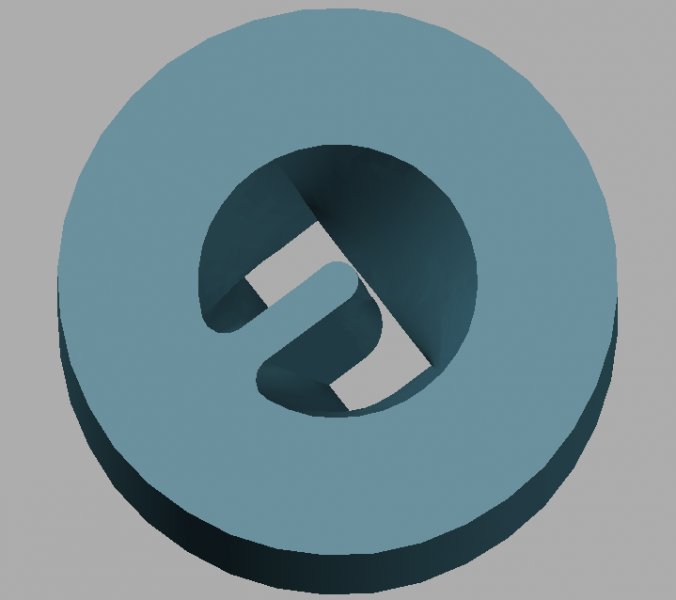

Plate thingy. I like this view better. Best I can do in a rush.
BINGO! thats exactly what I have been trying to do.....but the inevitable question. How?
now imagine moulten plastic flowing through that, creating that C channel shape....
LOFT command using the Guides option.
Though how did you get it to be hollow in the middle. I must be doing something wrong.....
WAIT, back up. I did it. I think. It was as simple as using the subtraction command. Well thats all great and all. Now to separate the plate into about 4 pieces like an exploded view.

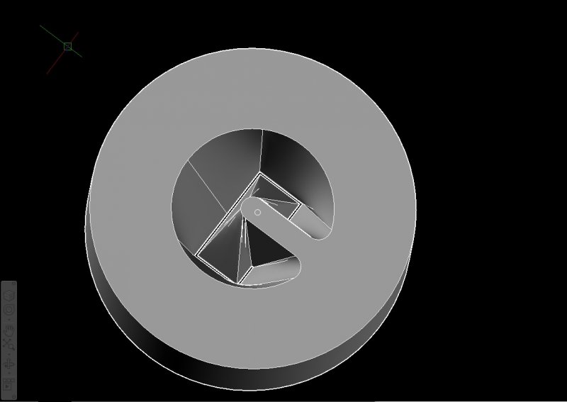

Here is my result after a couple of hours of tinkering at work....

The opening in your object does not appear to go all the way through it.
It may seem like that, but the opening is really small. About .050" to be exact, as per the thickness of extruded plastic.
