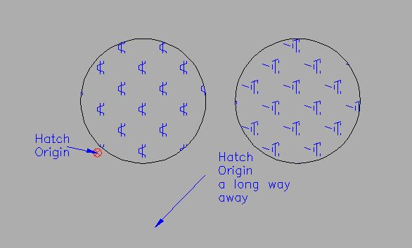

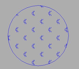

eldon Posted April 23, 2013 Share Posted April 23, 2013 Another thing that I should mention. is to keep the hatch origin near the hatched area. It seems that with all hatch definitions that use a non-integer angle, the further away from the hatch origin you get, there is a displacement, due to the angle and the x,y offsets not being defined with enough decimal places. A prime example is the Gravel hatch, which only has the non-integer angles defined to 4 decimal places. This produces results with the shape lines not being together Quote Link to comment Share on other sites More sharing options...
