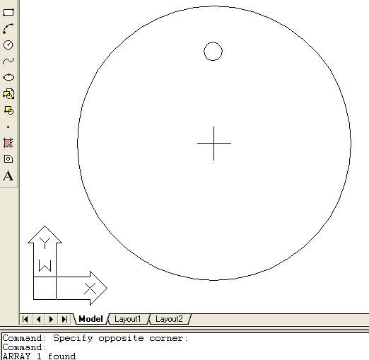

Here is the screen shot and the Autocad file. Is my Command Line set up correctly, if it isn't, how do I correct it please?

The instructions given in the previous posts seem to be right on the money,
and pretty simple to follow. Your commandline looks fine.
I just did a polar array without incident, as previously described,
with the exception of defining the degrees by pulling on the array grip,
as I was working from the commandline prompts instead of the dialog box.
Worked like a charm.

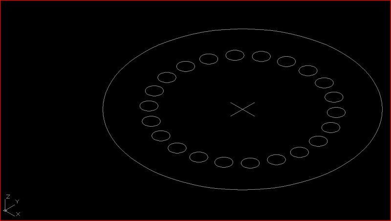

I would move the small circle to lie on the larger circle. Then array works.
Thank you Gentlemen. I was able to get v 2007 to work fine.
