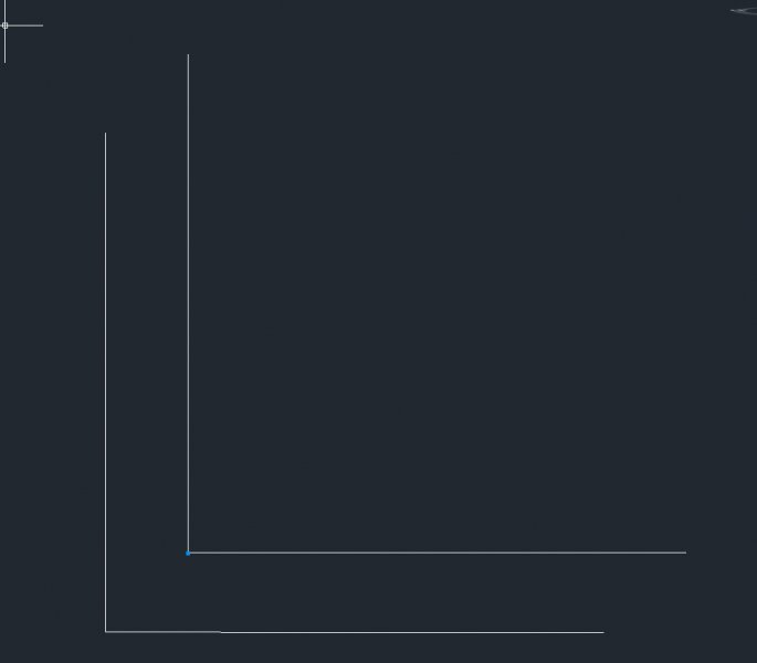

spudstud Posted April 19, 2013 Posted April 19, 2013 I'm absolutely brand new to AutoCad, running AutoCad 2013 for Mac. I've been working on this for 2.5 hours and I can't understand how this is so hard! I have drawn 2 shapes that look like the letter L . Both "L"s are parallel to each other. I want to move the one "L" so it is exactly 1/16" of an inch away from the other on all sides. I've watched every youtube viedo I can find, and it seems like "offset" is the way to go, but offset only offsets new lines, not existing ones. I've also been trying distance, but that seems to me more about measuring than setting distance. Quote
Dadgad Posted April 19, 2013 Posted April 19, 2013 Welcome to CADTutor. You could use OFFSET or COPY to create new lines, or use offset to create temporary work lines indicating where you want to move the existing line. When drawing lines, which appear to want to be accurate, you should probably turn on ORTHO (for orthogonal), so that your lines are constrained and don't wander around. I noticed that the lower of your two somewhat horizontally displayed lines is fragmented, indicating that it is not truly horizontal, which I would guess was your intention. I suggest that you go to http://www.we-r-here.com/cad/ , which would be a very good place for you to start. I used it myself about 4 years ago when I started self instructing online. Have fun, this is an amazing tool, be patient and go to that site and start working through the very well thought out beginners instruction lessons. Quote

eldon Posted April 20, 2013 Posted April 20, 2013 I would go for COPY with a relative displacement of 1/16,1/16. Quote

eldon Posted April 21, 2013 Posted April 21, 2013 From the OP's picture, it would appear that COPY is the way to reproduce the picture. BUT it might be that OFFSET is what is actually required. The OP will choose the right route. I was a bit worried about the assertion that OFFSET could not work on existing lines Have I been doing it wrong all these years Quote

welldriller Posted April 22, 2013 Posted April 22, 2013 Why not erase the 2nd L and offset the one left 0.0625 There is more than 1 way to skin a cat -- will this work for you set OSNAP on select LINE select INTERSECTION of the first L on command line type @0.0625 select ENTER select MOVE select both lines of the 2 L (if not a block) select INTERSECTION of 2 L select END of 45 degree line select ENTER erase the 45 degree line that you drew Hope that this will help NOTE: when you select INTERSECTION it may show as END (it does on my machine) Quote
eldon Posted April 22, 2013 Posted April 22, 2013 on command line type @0.0625 I think that this should read "on command line type @0.0884 otherwise the offset distance is not 1/16" Quote
Dadgad Posted April 22, 2013 Posted April 22, 2013 I think that this should read "on command line type @0.0884 otherwise the offset distance is not 1/16" Hard to refute that logic. One of the nice things about math, until you get to the theoretical level, where it all sort of becomes a hypothetical blur in a black hole. Well spotted. Quote
BIGAL Posted April 22, 2013 Posted April 22, 2013 A way to do it one go snapang 45 copy pick L base point = cnr 'cal sqrt(2)*dist required bingo all done snapang 90 Quote
