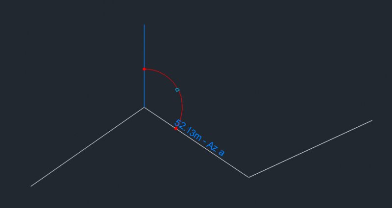

My unit settings are decimal , grads ,clock wise ,and direction noth and i use annotation texts.
I update the code but i have the same problems
1) I change the rad to grad but the angle is in dregrees (i dont know why)
2) the direction is clockwise
3)I try to change the direction to north but i am not sure if is correct . I want to calculate the angle a
4)I add a layer
5)I add annotate text style (but is not working with the text , something is missing). I want the paper text height to be 2.5 not the text height in model space
Can any one help ?
thanks
