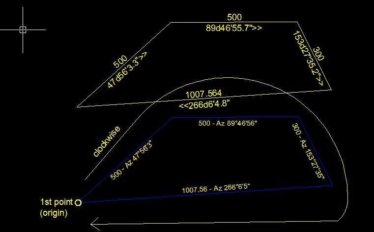

Hi
My file attached can explain better my task, guys.
I really appreciate any help.
Thank you

May i suggest something different:
Launch notepad:
Typed in data
Distance,Angle [angle+minutes+sec]
Distance,Angle [angle+minutes+sec]....
Save file and close notepad
Prompt for Text Height
Pick start point.
Read file
Bam bam bam.. [draw pline and text]
Close file
Done.
Sounds easy eh? :)
Here you go.

command: Demo
fill the data with this format
@500
@500
@300
@1007.56
Pick Start point:
Enter Text height: 20
HTH

          (setq txht (getreal "\nEnter Text height:"))
     (command "_pline" sp)
     (foreach itm ptlst
       (command "_non" itm)
       (setq pts (append pts (list (getvar 'Lastpoint))))
     (command "")
     (mapcar '(lambda[b] (j k)[/b]
               [b] (setq str (angtos (setq ang (angle j k)))
                      str (strcat (rtos (distance j k) 2 2) " - Az "  (vl-string-subst "%%d" "d" str)))[/b]
		(entmakex
                         (list (cons 0 "TEXT")
                               (cons 10
                                     (Setq p_
                                            (polar j
                                                   ang
                                                   (* 0.5 (distance j k))
                               (cons 11 (polar p_ (+ ang (* pi 1.5)) txht))
                               (cons 40 txht)
                               (Cons 50
                                     (if (setq ro (< (/ pi 2.0) ang (* pi 1.5)))
                                       (+ ang pi)
                                       ang
                               '(72 . 4)
                               '(73 . 3)
                               (cons 1
                                     (if ro
                                       (strcat "<< " str)
                                       (strcat str " >>")
             pts
             (cdr pts)
command: Demo2
Edited by pBe
Alternative code

Is that directed to me or BIGAL? Does that mean instead of "500 - Az 47d56'3.3" in would show
Distance: 500
Azimuth:
Distance: 500
Azimuth:

what of 45d2'3"=45.23? or
45d23'3" = 45.233? which digits are for minutes and seconds? how can you tell?

Is it that hard to type in @500 an azimuth equivalent 123.4557 and distance 500? if the only issue the "d" and quote symbols then you can be prompted with 123-45-57, the issue here as shown on post # 14 is the distinction between minutes and seconds. where does one end and the other start?
45.233 ----> 23'3" or 2'33"?
Also it appears that you want to "see" the lines being drawn on the screen as oppose to what i suggested and proven to you, input all the values then draw the polyline in one go [much like alanjt's code, can be modified wherein you'll prompted for input THEN draw the polyline].
The real issue here me thinks is the ease of typing in the value by avoiding the other symbols. Now if you or Bigal can shed light on the minutes and seconds issue then if should be easy cheesy japanesey.
sorry for my poor understanding :)
When you use this system of entering angles, you are very careful to always use two digits for both the minutes and seconds.
So 45d3'5" would become 45.0305
There are some who insist on having 3 digits for the degrees, and put leading zeroes if necessary.
