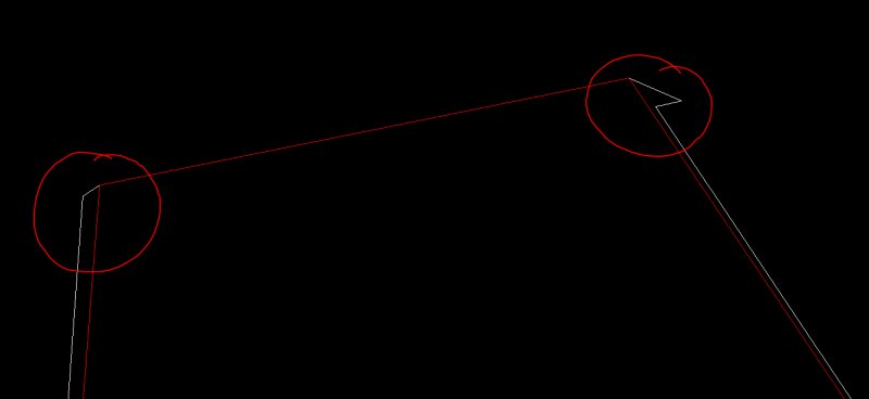

ReMark Posted April 17, 2013 Posted April 17, 2013 I could do it but it looks like the conversion process wasn't that clean. If you zoom in on what appears to be the intersection of two lines in actuality the linework takes a jog that includes two short line segments. In other words the underlying geometry is not clean; there are some flaws. Quote
ReMark Posted April 17, 2013 Posted April 17, 2013 I think both of these corners show some deviation. The one on the right is particularly annoying. This happens to be in the geometry on the outer edge of your circle. Quote
JD Mather Posted April 17, 2013 Posted April 17, 2013 I would start over from scratch and model straight lines as lines and circles as circles and arcs as arcs (rather than as splines). Quote
f700es Posted April 17, 2013 Posted April 17, 2013 I agree with Remark and JD and either start over in CAD or use the Illustrator output as a base to start from. Maybe bring it in and draw over it from scratch and just use the other image as a guide. Can you share the original .ai file (or maybe export it to another vector format, .wmf etc.)? Quote
