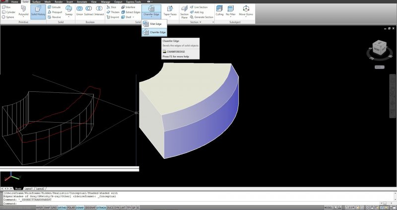

@complete - i guess a CHAMFER command will help you to achieve that detail. Is this the one what you we're trying to achieve?If so, refer to the picture, what I did is I create first the profile for extrusion.(though press/pull will also work)then I extrude it then I apply the Chamfer command, I apply the chamfer to the edge highlighted with red on the left.Apply the Distance of Chamfer this refers to Distance1 & 2 just play with it to see how it works.Also, Welcome to CADTutor Forum.regards :)
Worked like a treat:lol:. Thx alot.
You're welcome. :thumbsup:

Your original attempt shows parallel sides.
Rewind shows angled (pie shape) sides.
If the Rewind's solution is what you are after you could draw the end profile and Revolve the desired angle.

I created that using Circle + Offset + Line to close the profile + Trim then Extrude .JD's suggestion is definitely correct, you can simply draw the end profile and apply the REVOLVE command with defined angle of revolution.You can play in any solution that you think is easy & comfortable for you. Sometimes it just depend on what is needed to execute the modeling. And practice help you a lot into modeling. Hope it helps.
