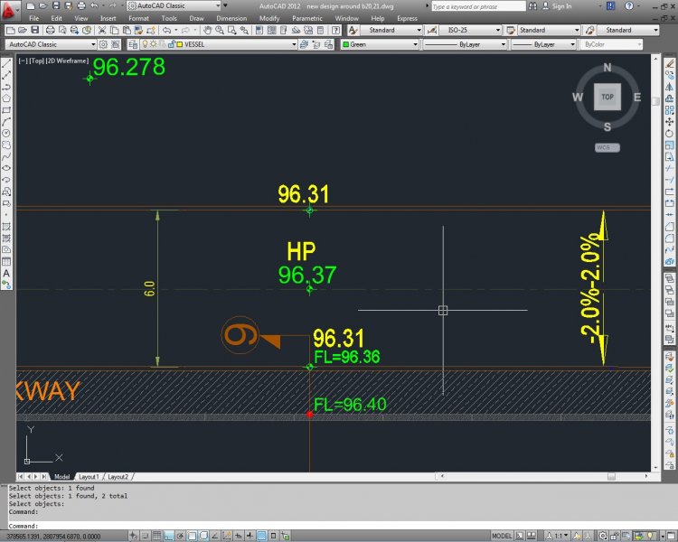

meric_u2003 Posted April 16, 2013 Share Posted April 16, 2013 Hi Mmebers, I have some ground elevations in my drawing i want to substrat 0.3 or 0.5 from tht value and also after changing i need to change the colour of the value same time.Is there any lisp for that?? Any one can help me.. sorry for my bad Englsih Quote Link to comment Share on other sites More sharing options...
Lee Mac Posted April 16, 2013 Share Posted April 16, 2013 Try this program: http://www.cadtutor.net/forum/showthread.php?45679&p=509051&viewfull=1#post509051 Quote Link to comment Share on other sites More sharing options...
Tharwat Posted April 16, 2013 Share Posted April 16, 2013 This ... ? (vl-load-com) (defun c:Test (/ kw no s) ;;---- Tharwat 16. April. 2013 ----;; (if (and (progn (initget "Add Subtract") (setq kw (getkword "\n Choose one [Add,Subtract] :")) ) (setq no (getdist "\n Specify the value :")) (progn (princ "\n Select Texts ") (ssget "_:L" '((0 . "*TEXT"))) ) ) (progn (vlax-for x (setq s (vla-get-ActiveSelectionSet (vla-get-ActiveDocument (vlax-get-acad-object)) ) ) (if (numberp (read (vla-get-textstring x))) (if (eq kw "Add") (vla-put-textstring x (strcat (rtos (+ (read (vla-get-textstring x)) no) 2 2)) ) (vla-put-textstring x (strcat (rtos (- (read (vla-get-textstring x)) no) 2 2)) ) ) ) ) (vla-delete s) ) ) (princ) ) Quote Link to comment Share on other sites More sharing options...
meric_u2003 Posted April 16, 2013 Author Share Posted April 16, 2013 I mean like this from those values i want to substract or add... there is a lot of values to be done like 96.04-0.03=96.01 likewise like while am clicking on tht number it automatically change Quote Link to comment Share on other sites More sharing options...
Lee Mac Posted April 16, 2013 Share Posted April 16, 2013 Did you try the program I suggested? Quote Link to comment Share on other sites More sharing options...
Tharwat Posted April 16, 2013 Share Posted April 16, 2013 Try this ... (vl-load-com) (defun c:Test (/ kw no s st v) ;;---- Tharwat 16. April. 2013 ----;; (if (and (progn (initget "Add Subtract") (setq kw (getkword "\n Choose one [Add,Subtract] :")) ) (setq no (getdist "\n Specify the value :")) (progn (princ "\n Select Texts ") (ssget "_:L" '((0 . "*TEXT"))) ) ) (progn (vlax-for x (setq s (vla-get-ActiveSelectionSet (vla-get-ActiveDocument (vlax-get-acad-object)) ) ) (if (numberp (read (vla-get-textstring x))) (progn (setq st (vla-get-textstring x) v (rtos no 2 2) ) (cond ((eq kw "Add") (vla-put-textstring x (strcat st "+" v "=" (rtos (+ (read st) (read v)) 2 2)) ) ) (t (vla-put-textstring x (strcat st "-" v "=" (rtos (- (read st) (read v)) 2 2)) ) ) ) ) ) ) (vla-delete s) ) ) (princ) ) Quote Link to comment Share on other sites More sharing options...
BIGAL Posted April 17, 2013 Share Posted April 17, 2013 Tharwat you dont need add or subtract as a option a negative value implies when added to a number to subtract anyway. Hence the wording enter height adjustment. Just realised a simple problem in the code posted including mine need a extra question decimal places required set it say at a default value so can do a enter for default. 0 1 2 3 . Also does the code need to be able to change the FL=90.36 to FL=90.06 this can be done quite easily as a variation on the code's posted thanks to Lee's parse number lisp. Heres a double version pick pick etc or multi pick an oldy quite a few years ago ; Adds a fixed amount to a number ;(PRINC "\nTO USE JUST TYPE A2L or A2LM for multiple ") (Alert "TO USE JUST TYPE A2L or A2LM for multiple ") ;(setvar "cmdecho" 1) (setq olddimzin (getvar "Dimzin")) (setvar "dimzin" 0) (DEFUN c:A2L () (setq v2 (getreal "\nEnter ht adjustment ")) (setq test 1) (while (= test 1) (setq en1 (car (entsel "\nSelect text number:" ))) (if (/= en1 nil) (progn (setq el1 (entget en1)) (setq v1 (atof (cdr (assoc 1 el1)))) (setq a (+ v1 v2)) (setq b (rtos a 2 3)) (setq el (subst (cons 1 b) (assoc 1 el1) el1)) (entmod el) ; (entupd en1) );progn (princ "\nplease pick again"); else );if ); while true (setq el nil) (setq en nil) (setq a nil) (setq v1 nil) (setvar "cmdecho" 1) (setvar "dimzin" olddimzin) (princ) ); END a2l DEFUN (defun c:A2LM () (setq v2 (getreal "\nEnter ht adjustment ")) (setq ss (ssget (list (cons 0 "Text")))) (setq len (sslength ss)) (setq x 0) (repeat len (setq en1 (ssname ss x)) (setq el1 (entget en1)) (setq v1 (atof (cdr (assoc 1 el1)))) (setq a (+ v1 v2)) (setq b (rtos a 2 3)) (setq el (subst (cons 1 b) (assoc 1 el1) el1)) (entmod el) (setq x (+ x 1)) ); repeat (setq el nil ss nil) (setq en nil) (setq a nil) (setq v1 nil) (setvar "dimzin" olddimzin) (setvar "cmdecho" 1) (princ) ); END a2lm DEFUN 1 Quote Link to comment Share on other sites More sharing options...
meric_u2003 Posted April 17, 2013 Author Share Posted April 17, 2013 thnks guys it helps me a lot exp. Mr.Bigal's lisp thnks for ur effort guys Quote Link to comment Share on other sites More sharing options...
Ish Posted December 21, 2021 Share Posted December 21, 2021 (edited) On 4/17/2013 at 6:44 AM, BIGAL said: Tharwat you dont need add or subtract as a option a negative value implies when added to a number to subtract anyway. Hence the wording enter height adjustment. Just realised a simple problem in the code posted including mine need a extra question decimal places required set it say at a default value so can do a enter for default. 0 1 2 3 . Also does the code need to be able to change the FL=90.36 to FL=90.06 this can be done quite easily as a variation on the code's posted thanks to Lee's parse number lisp. Heres a double version pick pick etc or multi pick an oldy quite a few years ago ; Adds a fixed amount to a number ;(PRINC "\nTO USE JUST TYPE A2L or A2LM for multiple ") (Alert "TO USE JUST TYPE A2L or A2LM for multiple ") ;(setvar "cmdecho" 1) (setq olddimzin (getvar "Dimzin")) (setvar "dimzin" 0) (DEFUN c:A2L () (setq v2 (getreal "\nEnter ht adjustment ")) (setq test 1) (while (= test 1) (setq en1 (car (entsel "\nSelect text number:" ))) (if (/= en1 nil) (progn (setq el1 (entget en1)) (setq v1 (atof (cdr (assoc 1 el1)))) (setq a (+ v1 v2)) (setq b (rtos a 2 3)) (setq el (subst (cons 1 b) (assoc 1 el1) el1)) (entmod el) ; (entupd en1) );progn (princ "\nplease pick again"); else );if ); while true (setq el nil) (setq en nil) (setq a nil) (setq v1 nil) (setvar "cmdecho" 1) (setvar "dimzin" olddimzin) (princ) ); END a2l DEFUN (defun c:A2LM () (setq v2 (getreal "\nEnter ht adjustment ")) (setq ss (ssget (list (cons 0 "Text")))) (setq len (sslength ss)) (setq x 0) (repeat len (setq en1 (ssname ss x)) (setq el1 (entget en1)) (setq v1 (atof (cdr (assoc 1 el1)))) (setq a (+ v1 v2)) (setq b (rtos a 2 3)) (setq el (subst (cons 1 b) (assoc 1 el1) el1)) (entmod el) (setq x (+ x 1)) ); repeat (setq el nil ss nil) (setq en nil) (setq a nil) (setq v1 nil) (setvar "dimzin" olddimzin) (setvar "cmdecho" 1) (princ) ); END a2lm DEFUN @BIGAL Edited December 22, 2021 by Ish H Quote Link to comment Share on other sites More sharing options...
