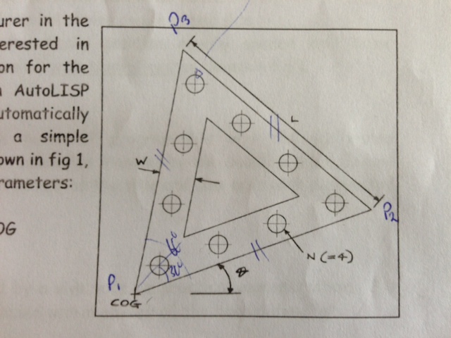

I have been asked to design a tri-gasket whereby the holes around the gasket are user defined. i am having problems with the code that defines where the holes are on the gasket ensuring they are equally spaced whenever the user changes the input. Any help would be much appreciated. attached is my code so far and a picture of what i want to achieve.

Yeh its an assignment. I looked earlier after you said this had been posted before but could find much relating to the command im after. I have had a look at some links on the web about the type of pattern im after, am i right in thinking i need a rectangular array command to copy the circle around the triangle?? i have a polar array command already but dont know how to change it to rectangular, any suggestions.

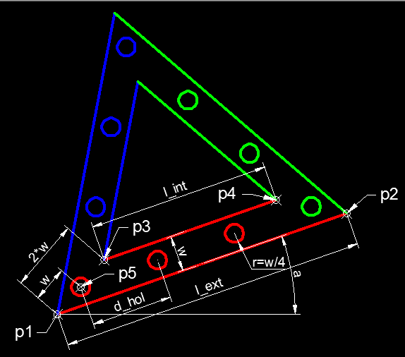

I will not post full program but just a few indications. I hope you will find a way to put all together.
First, grab all your inputs
(setq p1 (getpoint "\nStart point: "))
(setq p2 (getpoint p1 "\nEnd point: "))
(setq w (getdist "\nWidth: "))
(setq n (getint "\nNumber of holes: "))
Here you need to test if all inputs are valid.
Now lets calculate the constants within program
(setq l_ext (distance p1 p2)            ;length of exterior triangle
     l_int (- l_ext (* w 2.0 (sqrt 3.0)))    ;length of interior triangle = l_ext-2*w/tan(30); tan(30)= 1/sqrt(3)
     d_hol (/ (+ l_int l_ext) (* 2.0 (- n 1))) ;dist between holes = [(l_ext+l_int)/2]/(n-1)
The relative position of some elements in this figure is the same for each of triangle's sides, so we can use this property in a loop. See attached image for notations. I used colors to show objects created in each step in repeat loop.
(repeat 3
(setq a  (angle p1 p2)
     p3 (polar p1 (+ a (/ pi 6.0)) (* 2.0 w))
     p4 (polar p3 a l_int)
     p5 (polar p1 (+ a (/ pi 6.0)) w)
[color=blue]<draw_line p1 p2>
<draw_line p3 p4>
<draw_circle p5 radius>[/color]
(repeat (- n 2)
(setq p5 (polar p5 a d_hol))
[color=blue]<draw_circle p5 radius>[/color]
);end repeat n-2
(setq p2 p1
     p1 (polar p1 (+ a (/ pi 3.0)) l_ext)
);end repeat 3
Edited by Stefan BMR
From your program thus far, it appears you can figure out how to find the points to draw the inner and outer triangles. The holes are along a triangle as well. All you have to do is divide the side length of this third (middle) triangle by the number of holes along a side minus one to get your distances to the intermediate points.
