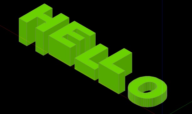

Is there a way to type text outlines in autocad and then extrude it?
Not sure of exactly what you are after, maybe this might be something close. If you use a thick font like ARIALBLACK, that has thickenss, you can use the express tools feature "txtexp" to explode the text. Youll have to modify and join the output polylines and join them to be extruded... clear as mud? something like this
Don't forget to use explode text with plan view!

Txtexp, then hatch, using select internal point. Hatch entire word/ sentence, paragraph, etc as desired at once, then edit hatch. Generate region from hatch. Extrude Region.
Quicker than exploding/editing polylines.
