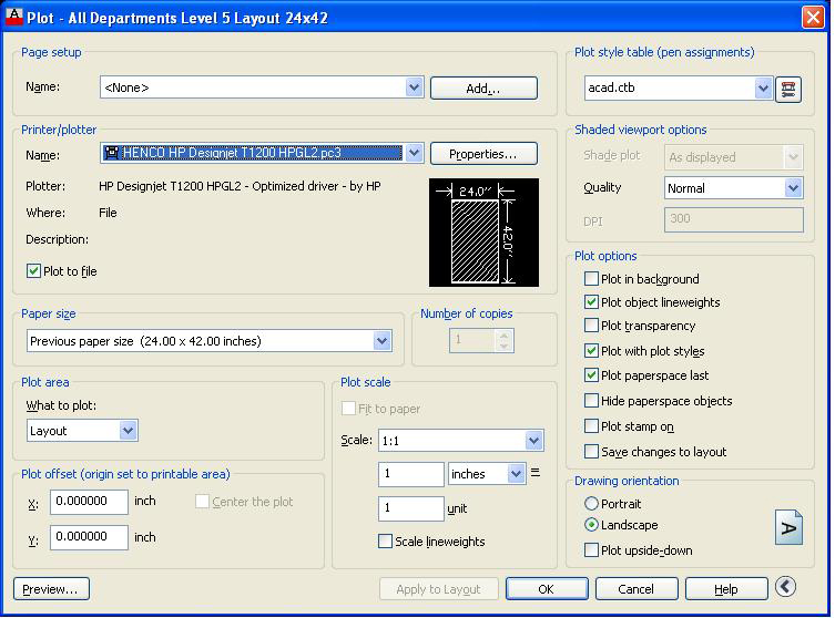

Yes, objects show up in print preview. Will try to post Screen shots. I cut off the titleblock since it contains our project information. One of the things that is not printing is the purple brackets. I hope this is enough to go by. I also attached the plot settings.
Plot Settings.JPG [ATTACH=CONFIG]41309[/ATTACH]
