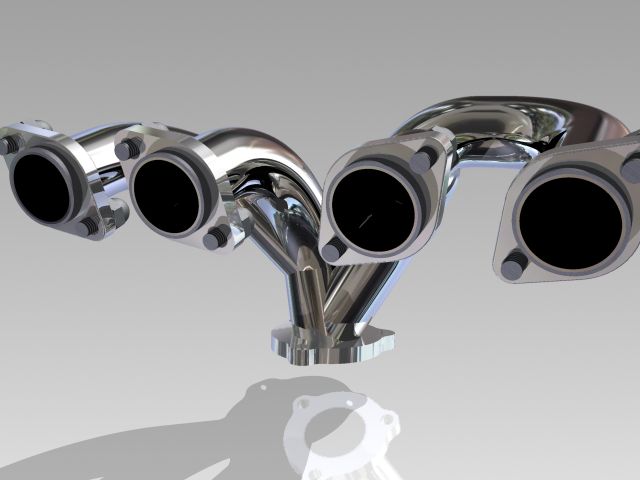

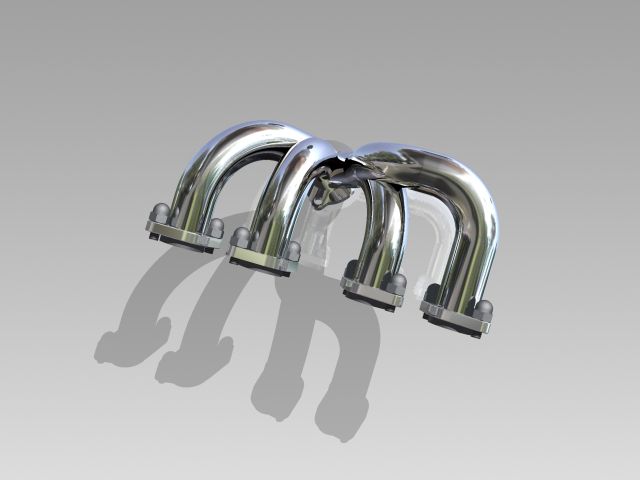

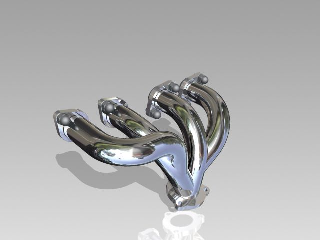

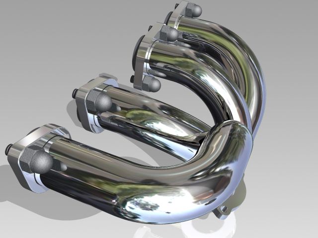

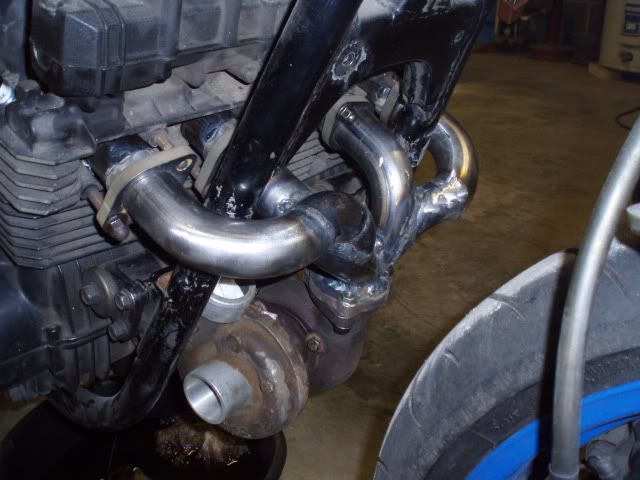

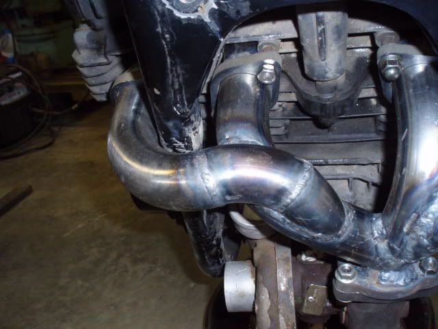

king. there is a certain order that things need to be welded when they do something like that. I welded the header pictured above this weekend and it was a pain because it was fully tacked and bolted to my jig. Its usually a packaging issue. A lot of exhaust design on full body cars falls into the space you have available. On race cars thats not as much of an issue. If you look at a turbo race car you will notice there are some pretty creative exhaust setups AND they are long tubes before the turbo.
You can set up a path using a 3d sketch and sweep the tube along that. I believe you can measure the arc length of the sketch in model space but if you are using a certain radius bend and straight lengths it shouldnt be hard to figure out.
Bends in an exhaust create pulse reflections from the pulse waves created when your valves close. These bends and the location of the collector on NA cars/bikes have a big effect on the power curve. On a turbo setup the biggest thing is getting the pulses to hit at different times. The performance gained from a true equal length setup isnt seen unless you have a full bore race motor where every little bit counts. The biggest benefit you can do is run a turbo with a split tang hot side and keep your opposing cylinders(firing order) separated.
you can see in my case there was no way to get an equal length setup using pre bent tubing. If i was able to make some custom tight bends it may have been possible but not probable.

hi there, which program did you use to make these headers? and make them look so realistic?
yea explain in-depth ;)
used a hdr?
everything was modeled and rendered in Inventor 2010. The flanges I had already drawn for the actual product so i just made an assembly and put the flanges where they needed to be then made a few sweeps and voila.
really??
ive been trying to render in inventor many times.. its really hard to get it right.
Good work man
it does take some playing around with the lighting and scene to get things right but you can produce some nice renders with it. Set up a scene with reflection images(all pre loaded in inventor) and play around with the available sample light scenes.
