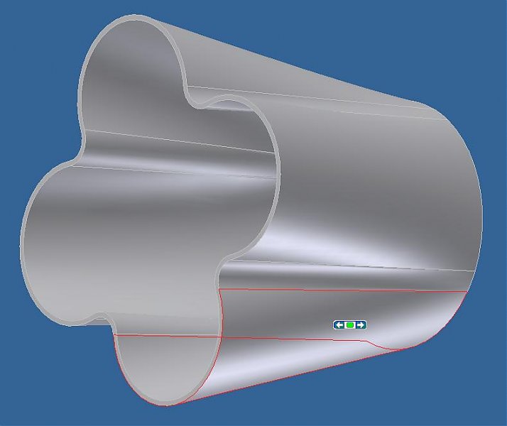

jwebleyj Posted November 17, 2008 Posted November 17, 2008 Hello everybody, What I am trying to do is draw a four into one tubular exhaust manifold. The tubes will run between two planes at right angles to each other. The planes have center points on them. I imagine I need to do a 3D path for each tube, then sweep the profile along the path. My problem is how to make the ends of the paths co-incident with the center points placed on the work planes at each end. I would also like to force the last 30 - 50 mm of the pipes to be normal to the planes. Any ideas on how to do this please? I'm using Inventor 11 for this. Quote

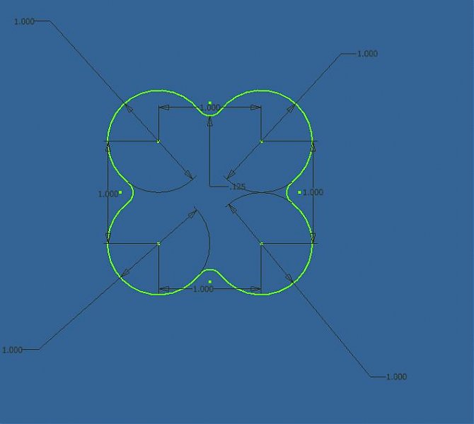

shift1313 Posted November 18, 2008 Posted November 18, 2008 i wouldnt try to do this all at once, draw a collector and then your runners. If you draw a collector say from your lager diameter down to a 4 leaf clover shaped segment that will match your runner OD. Then when you are drawing your 3d sketch you can use the center point of each one of these "leaves" to snap to. You will need to use loft for the collector and use sweep for the runners. ill try to draw something up real quick to show you. Quote

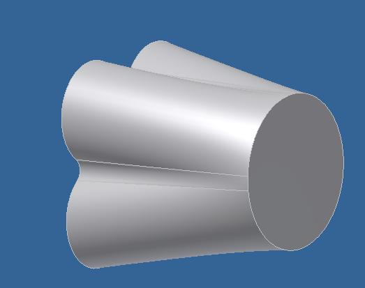

shift1313 Posted November 18, 2008 Posted November 18, 2008 okay i managed to squeeze in a drawing between other things to give you an idea. Here are a few screen shots. I drew the collector sketchs first, did a loft between the two, then i drew my 4 circles for the primaries at the head(where your flange would be), then i drew my 3d sketches. For my 3d sketchs i used a tangent constraint at my collector plane and at my header flange plane. i drew all straight lines and used the Bend with my radius of bend and applied it to all the hard corners. I didnt give anythought to this layout so i know a few tubes intersect:) oh yeah i drew everything as a solid and used the shell command to get my tubing. all in inventor 11pro Quote
jwebleyj Posted November 18, 2008 Author Posted November 18, 2008 That looks pretty well what I'm after, thank you very much. As you suggested I have already drawn the collector box (did it as a weldment). The flanges are also drawn on the other plane. I was having trouble with the 3D paths, but your suggestion of the tangent constraint has fixed the problem I reckon. Great, thanks once again. We are not alone, as they say. Quote
shift1313 Posted November 18, 2008 Posted November 18, 2008 good luck with it and let us know if you get stuck on anything else. the catch to the 3d path constraint is you need a plane, unlike 2d where you could be tangent or perp to another line. The drawing part is easy, i think figuring out your paths will be the hardest. are you actually going to build this? and what motor is it for? One thing i have seen done for making collectors is waterjet or laser cut an "X" that will fit between your 4 tubes. weld from the inside. then 4 pieces to fill in the outside to make a rectangle. good luck with the project. Quote
