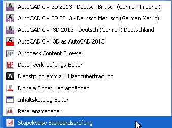

I just checked my AutoCAD Civil 3D 2013 and over START > All programms > Autodesk > AutoCAD Civil 3D 2013 in the resuling drop down menu there is no option to export or import custom settings. I'm not sure on the precise English wording as I'm running a German version and don't have a vanilla AutoCAD here in the office. I also checked all versions of C3D back to 2008 and it was the same there too.

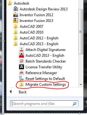

Is there an option similar to this under Start > All Programs > AutoDesk?

This is what I have when going in over the START button.
Well that's interesting. Thanks, Tyke for the info and the image.
You are more than welcome. And as you can understand German, you will understand the image text. Hint: compare the icons to get the translation ;) if you get stuck.
