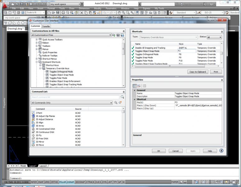

I think is the Solution in CUI in shortcut Key you can see the attachmen01-04-2013 08-58-26 م.jpgt
The OP is using 2004 so the CUI is not a solution. HP has the F keys defined for their product, editing the BIOS brings the F keys back to their original settings for windows.
oops I did not take into account he use 2004
