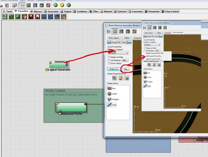

Danny Posted January 3, 2014 Author Posted January 3, 2014 OK never seen that, give me a minute Quote
Danny Posted January 3, 2014 Author Posted January 3, 2014 Hmmmmm, I guess I misunderstood. On the website it states that: And at the world machine forum I found a discussion about problems when importing dxf files, and a supposed fix implemented in build 2.3.1, but no mention of how to import them: http://forum.world-machine.com/index.php?topic=2154.0 Thanks for the info. I guess I'll just keep creating my terrain the old fashioned way. Ok not knowing how you intend to use this, theres no way of loading a dxf mesh in WM. There is a way to use dxf through the layout generator. Not sure what the benefit is because you can do this within WM with the Lines command, but for scaling purposes between applications this would come in handy. Good luck with your project Quote
Cad64 Posted January 4, 2014 Posted January 4, 2014 Thanks for taking the time to check into this. I'm not looking to import a dxf mesh. I just want to be able to import a dxf containing elevated polyline contours that I get from the civil engineer and then use World Machine to generate the terrain. What I typically do is bring my contour lines into Studio Max and generate a terrain surface there, but it tends to create a really ugly mesh, so I was hoping World Machine could do a better job. I'll give it another try later on, when I have some spare time. Quote
Danny Posted January 4, 2014 Author Posted January 4, 2014 Thanks for taking the time to check into this. I'm not looking to import a dxf mesh. I just want to be able to import a dxf containing elevated polyline contours that I get from the civil engineer and then use World Machine to generate the terrain. What I typically do is bring my contour lines into Studio Max and generate a terrain surface there, but it tends to create a really ugly mesh, so I was hoping World Machine could do a better job. I'll give it another try later on, when I have some spare time. That will work for sure. World Machine is extremely flexible you will enjoy working with it. Have a great weekend Quote
