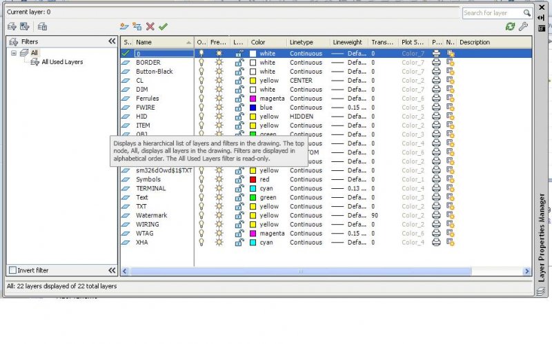

A far better way (although I do it as above) is to set up your layers first with colours and linetypes associated with each layer. A typical layer lable is shown here...
You can see each has a colour and linetype assigned. You can also see that I have layer 0 as my current layer (it is ticked). If I was to set CL as my current layer I could draw a line (and providing you still have Colour byLayer & linetype byLayer active) and it would be drawn with the centre line linetype and it will be yellow.
Just remember that with AutoCAD there are many ways to achieve the same result. Check your company standards to ensure they are happy with the way you are working. There are good reasons to not use "ByLayer" but more often it is changed through ignorance.
Thanks Dave,
I understand the concept of what you have said, but how would I insert a polyline into the layer ? as it only has linetype and lineweight from what i see in your picture?

Many ways....
you can set the layer you want as current and draw it directly on that layer
you can change it with the properties palette
if there is already an object similar you can use the MATCHPROP command
and several more that I can't currently think of.
As I said, I have my properties palette constantly available, it is incredibly versitile.
The other thing to look at often is the F1 help. It doesn't always help but it helps often enough to make it worth checking.
and of course, this forum. :thumbsup:
