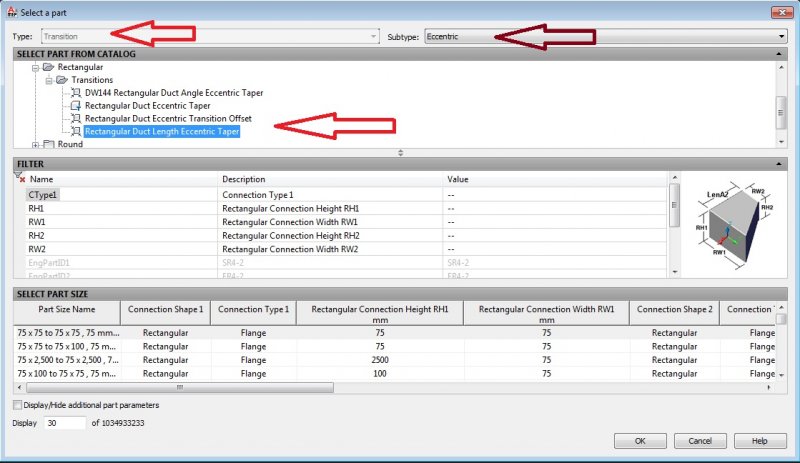

hoss Posted March 27, 2013 Share Posted March 27, 2013 You need to use Rectangular Duct Length Eccentric Taper Click on your transition part, click on the transition part image in the properties box, pick Transition under Type and Eccenric under Subtype your should be able to find this part there By the way, there is a MEP section in this Forum, so post your questions regarding MEP there Quote Link to comment Share on other sites More sharing options...
bissani Posted March 27, 2013 Author Share Posted March 27, 2013 That was Helpful. Sorry about posting here, didn't know there's an MEP section. Thank you, Quote Link to comment Share on other sites More sharing options...
